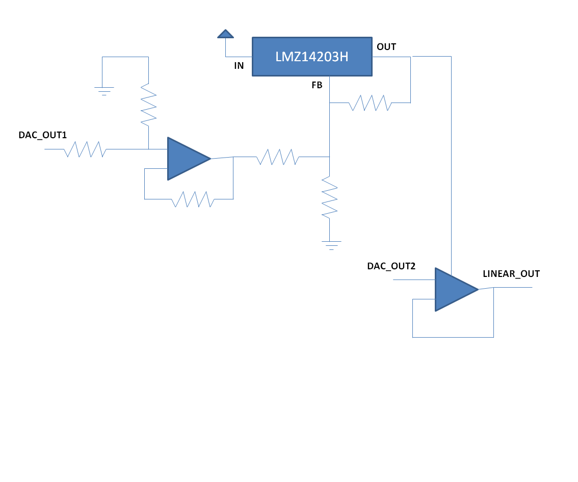

Hi all,
I want to use the LMZ14203H to set variable output voltage. For this reason I cannot use a fixed resistor vaules on the feedback input of the LMZ14203H. In want to use a dynamic configuration that can set the output voltage depending on an analog voltage that we can call vset. Looking to the datasheet I see that the LMZ adjust its output by means of a comparison between the voltage on the feedback point and a fixed 0.8V.
Now, I connected the feedback pin to the output of a circuit that gives:
Vo + 0.8 - Vset
where Vo is the LMZ output. This way, the LMZ works in order to have its output equal to Vset, thus having 0.8V to its feedback pin.
The circuit seems to work quite well, but its behaviour strongly depends on the value of the capacitance that I use in the LMZ output.
Is there an application note or some configuration to use a feedback pin as a vset adjusting pin?
Can anyone help me in this topic?
Thanks.
  • Hi Polp,
    There are a couple of options for adjusting the output voltage.
    1) You could use a VID controller such as the LM10010.
    2) You can add a second resistor to the FB node to subtract Vset from the output voltage.  Method Determine Top and Bottom resistorrs for nominal Vout + 0.8V.  Add a second top resistor but connect it to Vset instead of Vout.  When Vset is low the output voltage will be will be at its highest value.  When Vset is high the output voltage will be drop. You can adjust the gain with the resistor choice
    2620.Programmable_Power_Supply.pdf
    I attached an article describing the process.  Watch out, I remember the publisher added a typo on one of the equations but can't remember which one.
    As for the stability concern.  You might need to add  a capacitor to filter your Vset before it reaches this circuit to roll off any noise.
    Also, when you design the output capacitors you need to pick caps that are rated for the highest voltage you are seeing, but have enough capacitance for the lowest voltage.
    Regard,
    Marc

  • Hi Marc,
    I'm here again.
    I am currently using the LMZ14203H with the output adjustment voltage circuit you suggested me.
    The LMZ output is directly connected to the rail of a linear power amplifier. I want to adjust the rail in order to minimize the power consumption on the linear amplifier... thus I am adjusting the LMZ output depending on the amplifier input voltage (just setting the LMZ output to 1.5-2V over the linear amplifier).
    To this end, I noted that, even if I force the LMZ to be at 5V with the adjustment circuit, when I set the linear amplifier to 10V (just an example), the LMZ sets automatically its output to 11.5V that is the minimum voltage that allows the linear amplifier to work correctly.
    Is it a correct behaviour?
    Can I avoid to adjust the LMZ output just setting the linear amplifier expecting to have the LMZ setting its voltage to 1.5V over the linear amplifier?
    Thanks for your support.
    Polp
  • In attach you can find a simplified schematic of the circuit I am referring to.
    Specifcally, we have that:
    1 - (normal mode)
    DAC_OUT1 = 5V   --> LMZ_OUT = 12V
    DAC_OUT2 = 10V --> LINEAR_OUT = 10V
    or for example
    DAC_OUT1 = 0V   --> LMZ_OUT = 5V
    DAC_OUT2 = 3V --> LINEAR_OUT = 3V
    2 - (under investigation)
    DAC_OUT1 = 0V --> LMZ_OUT (expected) = 5V
    DAC_OUT2 = 10V --> LMZ_OUT = 11.5V ; LINEAR_OUT = 10V
    Is the 2- behaviour  correct?
    Can I normally use it?
  • Not sure what is happening, let me think about it.  Maybe a parasitic in the op-amp is turning on.
    Can you give me a plot of the output of the LMZ14203 vs DAC1 Voltage from 0 to 5 with DAC2 set to 3.3?
    Then do the same plot with Dac2 set to 10V.
    Marc
