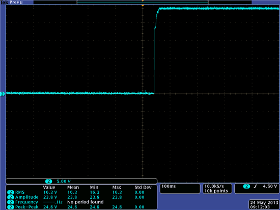

We built five prototypes with the same components. From 5 boards 3 works well (meaning when
we turn on the supply voltage and the board is unloaded the output becomes 24V).

    3 developed boards are working als we expected, meaning when we turn on the supply voltage, the unloaded output becomes 24V.
    Then we loaded the board with constant 1A. When we decrease the input voltage at 27V input we still have aprox. 24V at the output. Then of
    course the output voltage began to decrease. When the input voltage achieves 20V we still have aprox. 18V at output/by 1A constant load/.
    Under 20V input voltage the regulator switched off.

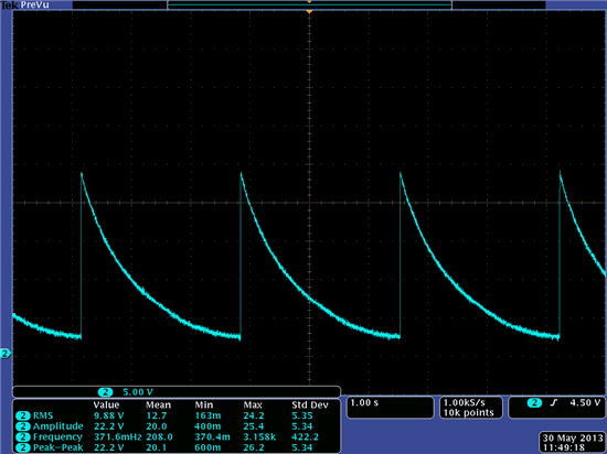

    we already read about this low load operation problem. And if we applied a greater than 25mA load, the IC worked. But if VIN drops to 24V or below the output starts oscillating:
    we applied your suggestions, but the result was the same. Moreover, 300ohm means an 80mA load, which means 1.92 watts, which means a fairly bulky resistor /unfortunately space is at premium and the resistor's high temperature is also undesirable/.
    The IC also worked when we plug our power module to the destination board / we have developed a motherboard, and our power module is a card which can be plugged into the motherboard/. The thing is that when the input voltage of the power module is increased instantly, everything works fine /unless we then decrease the input voltage to 24V or below, because then the oscillation starts/. But when the voltage increase is slow /due to the high input capacitance of our driving system/, we only get 5 volts on the output. Of course all of this applies only when the UVLO is set below 24V and the output is unloaded.
    Our question remains, is the LMZ14202H unstable when the UVLO is set lower than the regulated output voltage? Because if we set UVLO higher than 24V /we tried 27V / the output reaches 24V in all cases.
