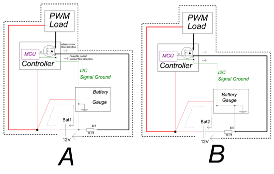

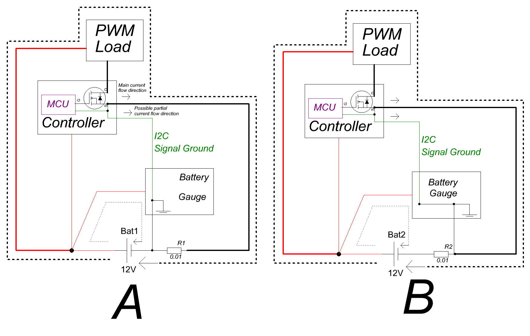

We are designing schematics with BQ34Z100 and have the following question:
Could the BQ34Z100 ground be connected to PACK- instead of BAT- as drawn on Figure 7.bq34z100EVM-001 Schematic?
Possible current can flow on I2C ground (not through sense resistor) connecting this way!
Look at my current flow diagrams! Could we use B instead of A?
Any other solutions?
Thanks in advance.
