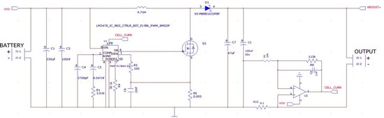

Hi all, I would like to use a LM3478 as a constant current supply at 1.0 amps 9 to 18 vdc. I have two ways i would like to do this one is by using a digipot in the voltage divider circuit that feeds the 1.26 volts to the FB pin. The other way I was thinking about is, can I send an output from an analog output pin on a pic to the FB pin directly, of course I would have a shunt and current measuring op-amp that would tell me when my load has reached 1.0 amps. Put another way, can I input a lower voltage then1.26 to the FB pin to increase Vout, then inject 1.26v when the I have satisfied the current requirement?  Would that work, why or why not?

  • I will look at the thread! I have a battery operated device and would like to run from 4 AA rechargeable batteries. The device only needs to run 20 - 25 minutes before recharging. So the source is not regulated. The input range would be from 3.6 to 5.6 volts. The output is correct 9 to 18vdc @ 1.0 amps. This is not an LED device it's an electrolytic device, it is a constant current device. I need to be to -/+5% from 1.0 if Thanks for the help !
  • Hello Bill,
    Thanks for the clarifications.  Attached is a scan of a hand-drawn schematic concept based on the LM3481. The LM3481 is a later incarnation of the LM3478 and is much better suited.
    In this application I have implemented current sense on the low side of the load. Is this permitted?
    I now realize that the resistor values for the output over voltage clamp divider string will need to be adjusted.
    3250.20130530160534610.pdf
    Note that this does not include and ON-OFF mechanism to disconnect the battery source from the supply input. Also note that the resistive divider for the output over-voltage clamp remains attached across the load when the supply is in shutdown.  There is a work-around if this is an undesirable discharge path once the load is charged and the supply is turned off.
    Additionally the input UVLO divider remains connected across the battery and will eventually deep discharge the battery unless we add some sort of on-off battery disconnect.
    This schematic is a starting point to get the discussion rolling, not the final solution yet.

    The current sense on the low side is permitted, and an elegant way to make a constant current supply at 1.0 amps. I have a couple of questions one, about the current sense resistors, because this is a battery operated device I don't want to spend the battery energy on the drop across the 1.25, 2 watt resistor. Is there a work around, my best is to take an op-amp and some and a very small valve resistor and set the gain such that the 1.275 volts will be created when the shunt sees 1,0 amps through it.
    Second, what is the best way to shut this chip down, I will be running a Pic processor, should I just use an open collector to power it up and then set the transistor base high from the pic output to shut the LM3481 off ?

  • Hello Bill,
    Thanks for allowing me to refine the circuit. The added components implement the best way to get zero power shutdown.  Hope it isn't too many parts.
    Alan Martin

  • Boost circuit using a LM3488. I have set this circuit up on the bench, it's a 1.0 amp constant current supply. I am getting some unexpected results, the FB pin from the op-amp circuit should be around 1.275v when the current is 1.0 amps through the load.  Instead, the load current reaches 1.7 amps and the FB signal is about 1.46v  . My op-amp and shunt circuit is working fine, shouldn't the output voltage stop climbing when the FB reaches 1.275v? What advantage does the LM3481 have over this chip in my application?
