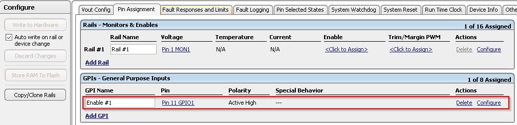

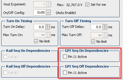

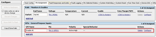

  • Question 1:  You can define a GPI under the Pin Assignment tab of the Configure page, I called this one Enable #1.
    Then return to the Vout Config tab and the pin will show up as avaliable for use as an On and/or Off dependency.
    Question 2:  The operation of PMBus_CNTRL can't be split for turn-on vs turn-off which will make 1-2-3 turnon and 3-2-1 turnoff sequence type impossible, however defining an individual GPI as an enable does allow this functionality.

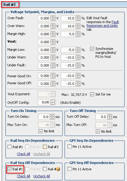

    For clarity, to make sure we are seeing things the same, below is screen shot of Rail_1 Sequence Off Dependency for Rail_2.
    So when Rail_1 goes below its PG level, Rail_2 will be sequenced off.

  • There was an error in my Question 2 response which I've updated, UCD90xxx sequencers use Sequence OFF Dependencies which require all depencencies to be met before rail turns off while my answer was based off the UCD92xx controllers Turn-off Dependencies which only require one of the defined sources to go away to cause the rail to shutdown.
    Therefore, PMBus_CNTRL pin can be used to initiate 1-2-3 turn-on and 3-2-1 turn-off with proper Sequence Off Dependency settings.

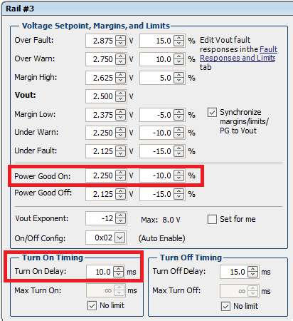

    2a)  Turn-on dependencies are event based while turn-on delays are time based.  If you have turn on dependencies in your configuration (and it looks like you do) then the delay timer to enable the rail will not start until the previous rail has passed its Power Good on threshold.
    Say Rail #4 is turn on dependent on Rail#3 pictured above.  Right when Rail #3 is enabled and is in the process of turning on, the turn on timing of 10ms for Rail #4 has not started yet.  Once the sequencer sees that the voltage rail has gone above 2.25V through the MON pin assigned to that rail,  the turn on delay will start.  You need to incorporate the power up time of each rail into your timings if you have turn on dependencies.
    2b) That is correct because you do not have any turn off dependencies.  You do not have to wait for the preceding rail to go below its Power Good Off value before the Turn Off Delay is enabled.
