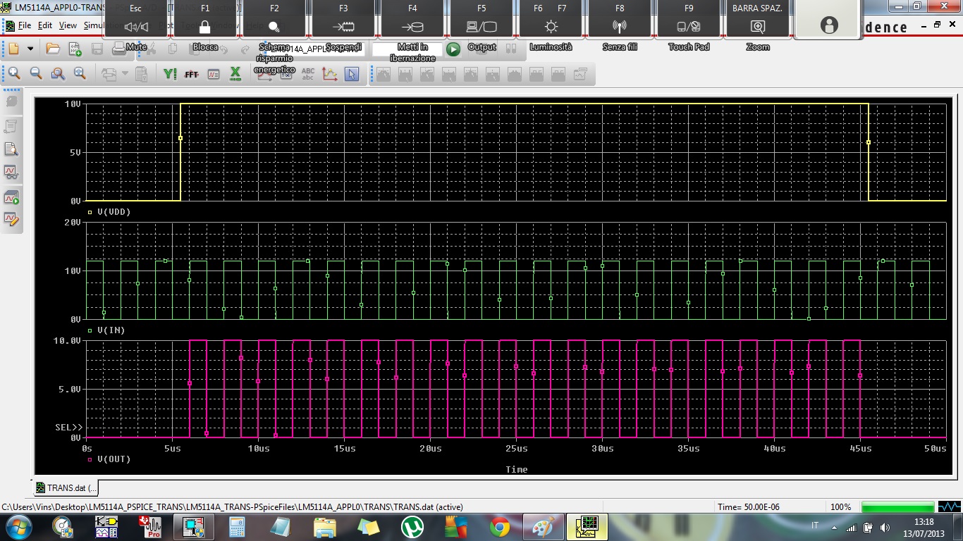

When I simulate LM5114 I get the following message:
ERROR -- '$' is not a model parameter name.
please note that our simulation models are encrypted and run only with Orcad PSpice 16.0 or higher...
Vincenzo

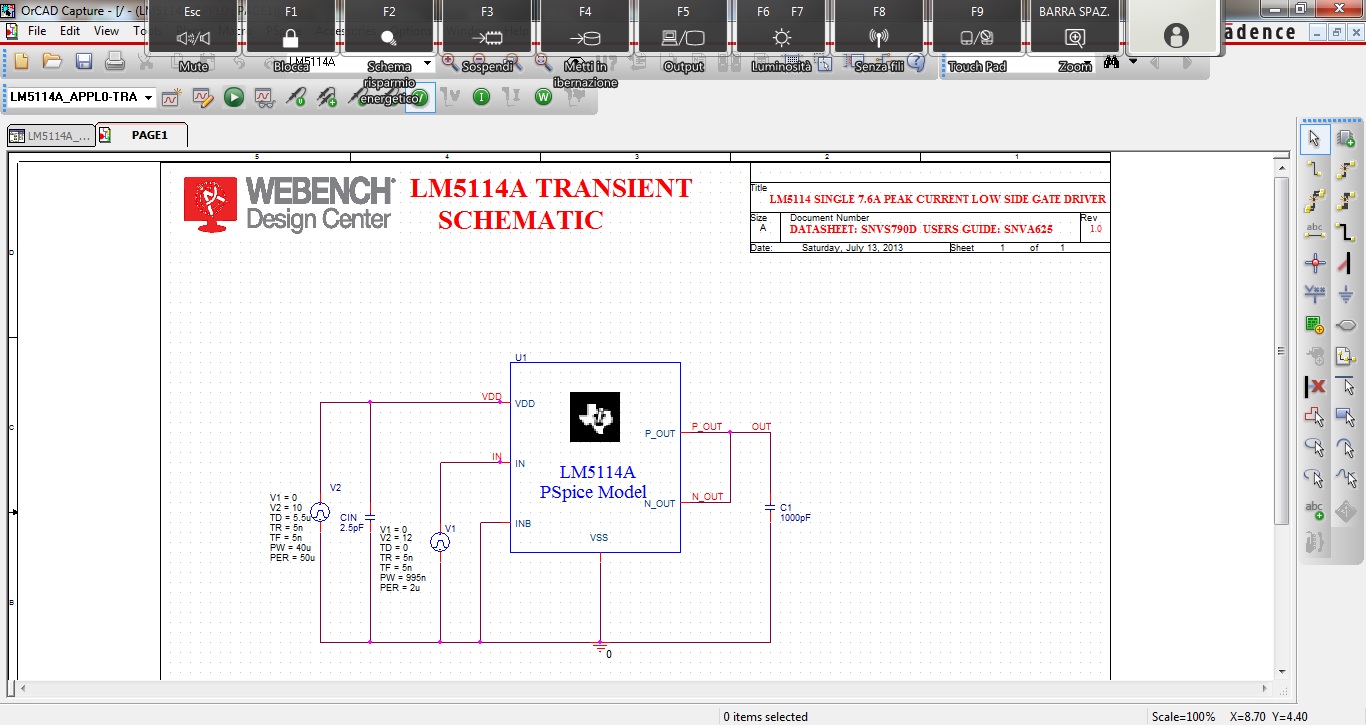

I tested the model on a 16.3 version and it works, as you can see on attachment...
the original model was developed in orcad 9.x or 10.x, can't remeber actually, so Orcad 16.x just "convert" it...
probably a problem in the conversion...
try the attached one (already converted in 16.3, so closer to your version)...
