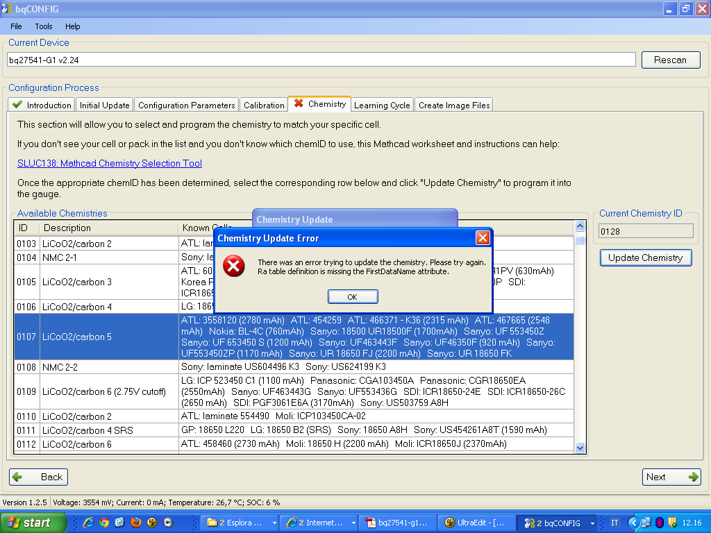

    I tried to update chemistry with bqConfig from default 0128 to 0107 and bqConfig returns to me always the following error: "there was an error trying to update the chemistry. Please try again. Ra table definition is missing the FirstDataName attribute" (see attached image)
    even if there is the error at least the chemistry ID in the flash is updated to 0107

  • If you try downloading the latest bqConfig, does the error go away? http://www.ti.com/litv/zip/sluc378d
    I haven't seen the error before, but it may not be affecting the programming if you're getting the ID to update. If you attach a SENC file I can verify if the ID is programmed correctly or fix it if it isn't.

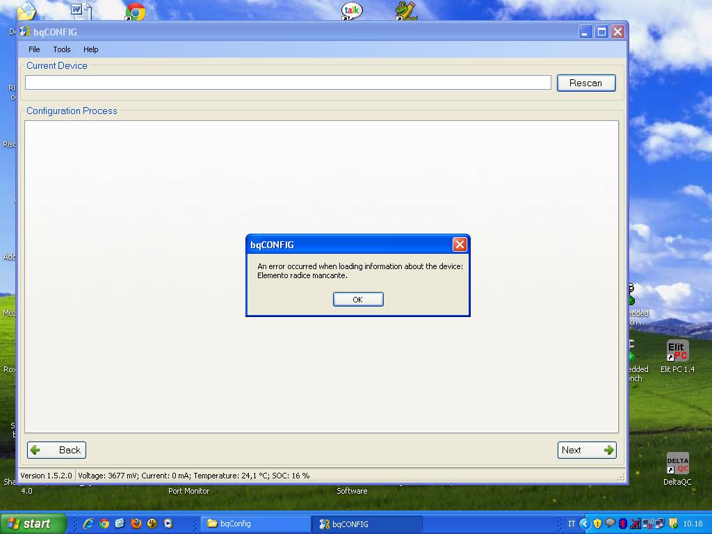

    I updated to the latest bqConfig 1.5.2, but this version doesn't seem to recognize the device. In attach the error I get

  • I checked the SENC file, and despite the error, the chemistry ID still programmed correctly. You should be fine to continue.
