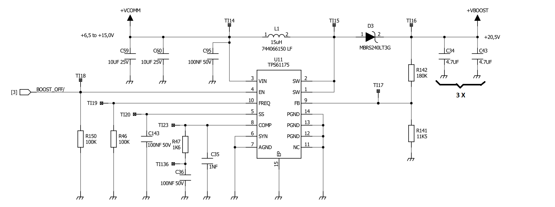

Here's the response from the link:
Dear person who can support the Soft Start setting of TPS61175.
In the datasheet, the typical Soft Start bias current is specified as 6uA. However, in the table-2 which is describing the relation between soft start time and soft start capacitor seems not much to the specified bias current, soft start capacitor  and threshold.
From the block diagram, the soft start bias current and threshold seems influenced by the COMP node bias and beta of the PNP transistor. Therefore, the caluculation of soft start may be much complecated.  (may be influenced by load current, inductor, frequency, input voltage etc...)
If you have any specific equation which enables us to estimate the relation of softstart time and capacitor, can you advise?
