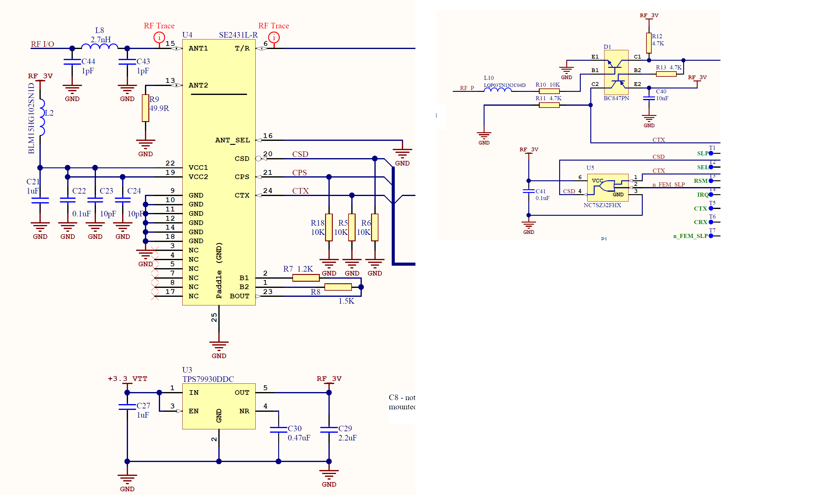

   We have used TPS79930DDC LDO to drive a RF Circuitry which consists BC847 BJT, NC7SZ32 OR gate, Front End module(FEM).
I am just elaborating my scenario.... I will my question at last. please bare with me.
It is EN is connected to input itself. NR has 0.47uF Cap to GND.
input voltage 3.3-3.6
Output Voltage : 3.0V
Output Current max going upto 280mA . without exceeding the maximum power dissipation.
we have an Issue, When we driven the FEM sleep mode , the whole circuitry is taking around 157uA of Current.
The variables i can see.
 Input leakage Current of OR gate = +/- 10uA
Quiscent Current of OR gate = 20uA
Quiscent Current(Ignd) of LDo - 40uA
Icbo of BJT - 10nA(approx)
there is 1 pull up of 4.7K on Collector to 3V.
Is there any minimum current requirement for LDO, becasue whole current added is <100uA

    1. under what conditions typ and maximum values can be considered.
    This is also not an issue. Problem is when we are entering into sleep mode the current consumption is 157uA.
    Total current calculated worst case is =70uA, there is a differnece of 90uA.
    2 .is there any possiblity that this additional current (90uA) is taken by the internal circuitry of TPS79930DDC.in addition to ignd of 40uA?
    There is no other element connected to this rail.
    Please let me know if i am not clear.
    1. The current limit spec is like any other spec on the PDS which has a lower, upper and typical limit. What this means is that different parts will have a different current limit value, some will hit current limit as low as 200mA, some as high as 600mA, but based on our characterization, a majority of the parts hit current limit at ~400mA. There are user no conditions which influence the current limit value, just process variations.
    2. Can you please share your schematic? This will help me help you better. However, the Iq is the urrent being consumed by the internal circuitry of the LDO. If your load is drawing 100uA, then the Vin pin of the LDO will pull Iq + 100uA from the power supply. So in your current consumption you have to take the load into consideration. Only when there is absolutely no load (open circuit), the current consumed by the LDO will be approximately 40uA.

    I can't share the schematics, But, i can give more details.
    THe loads connected to LDO are
    1. OR gate - upto 30uA it can take in sleep
    2. FEM (SE2431L) - max of 1uA
    3. BC847 - Icbo of 10nA
    They all comes totally about 32uA, but current measured from LDO input is 157uA. So, if Iq of LDO is removed from total current (157-32-40) = 85uA is somewhere consumed( we feel this can be consumed by LDO internal circuitry).
    can you give comments on this.
    The max spec for Iq is 60uA so it is unlikely that the LDO's internal circuitry is drawing so much current unless the part is damaged. Have you tried the following:
    • Isolating the load and measuring the current draw by the LDO when nothing is connected to the output?
    • Trying a different LDO unit to make sure the one you are using is not damaged?
    You are using the fixed version, so there can be no extra current flow through the resistor divider that is used in the adjustable version.

    I have tested this LDO sample on General purpose board in No-Load and with very less load combinations.
    It takes around 46uA of Quiescent current -this spec is almost as per the datasheet.
    In our circuit, even i have measured individual currents going into FEM, BC847N in sleep mode. they are as per datasheet specs. Because OR gate is QFN package i can;t able to measure the current it takes.
    t hs a
    one input state(nFEM_SLP) of OR gate is unknown. may be floating creating doubt. unfortunately it was routed in internal layers.
    if you see any discrepency please let me know.
  • Do you have leakage in your board?
