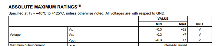

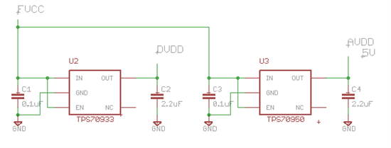

Does anybody know which are the failure modes for TPS70933?
I have a board with both TPS70933 and TPS70950, the TPS70933 is handling a load of a microcontroller and an AD7190 no more than 35 mA, but in both cases the regulator blew up (regulator output is only 0.7v) ,  there was smoke in one instance, after two failures, I decided to change the part for a MC33269DT-3.3   , this solved the issues.  I really want to keep TPS70933 but I'm unable to explain the part failure, I though that in any cause the curren limiting would kick in.
