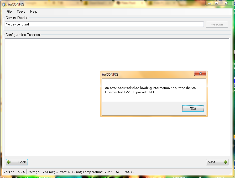

I need to review status table of gauge IC bq27425-G2A and I had a problem when working with EV2300 tool (PCB : HPA002 rev B).
I downloaded 3 application tools from website page for product bq27425-g2a : bqEVSW-bq27425g2 v2.05 , bq GaugeStudio v1.0.2 and bqCONFIG v1.5.2.
I used one tool at one time and double checked no other application activated with windows task manager.
EV2300 worked well with bqEVSW, however it 's not worked when open  bq GaugeStudio v1.0.2 (hit : no adapter or gauge found) and bqCONFIG v1.5.2 (reading fail).
The pictures of screen shot are below.  Please kindly help me.....

  • Also seeing this connection error from bqCONFIG program:

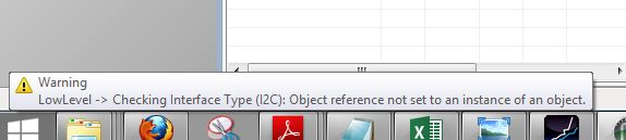

  • Should we use EV2400 instead of EV2300?
    This error message shows up in the bottom left corner of the GUI when I plug the I2C cable into the EV2300:

  • Hello Bryan,
    We have been trying to duplicate this issue on our systems, but have been unsuccesfful at capturing this failure.  At the moment we believe there might be some timing issues with the EV2300 and the new software that is coming out.  So, at the moment we have to suggest using an EV2400 instead of the EV2300.

  • Hi all,
    GaugeStudio works perfectly well with the EV2400 box. Problem solved on my end.
    Bryan
