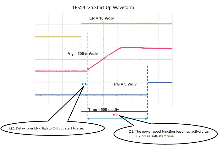

Please advice following questions from customer.
They needs following information to use PG to enable another regulator.
Q1:
Data-sheet explain "The power good function is activated after soft start has finished. The power good function becomes active after
1.7 times soft-start time.".
Please advice "1.7 times soft-start time." is from EN=High or Output start to rise ?
Q2:
There are delay from EN=High to Output start to rise.
Please advice how is this delay time and deviation.
