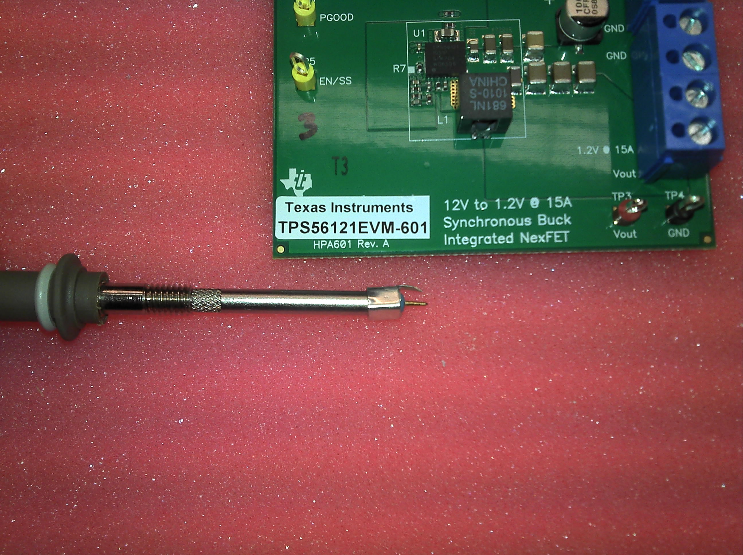

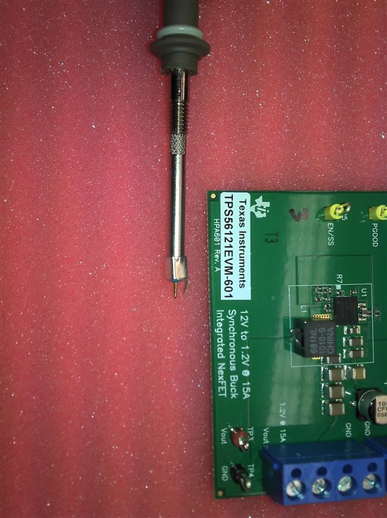

    When you measure the output ripple, it is important to follow good high frequency measurement methods. This implies an extremely small probe tip and equally short ground lead on the probe, see attached picture. Measure right across a ceramic output cap. The typical scope probe leads are far too long and will yield high frequency spikes and ringing that are not necessarily realistic. Don’t use the long ground lead included with the scope probe. Usually there are smaller clips included in the package, or you can make one yourself. For noise measurements like this, measurement technique is crucial.
