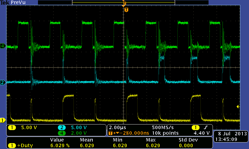

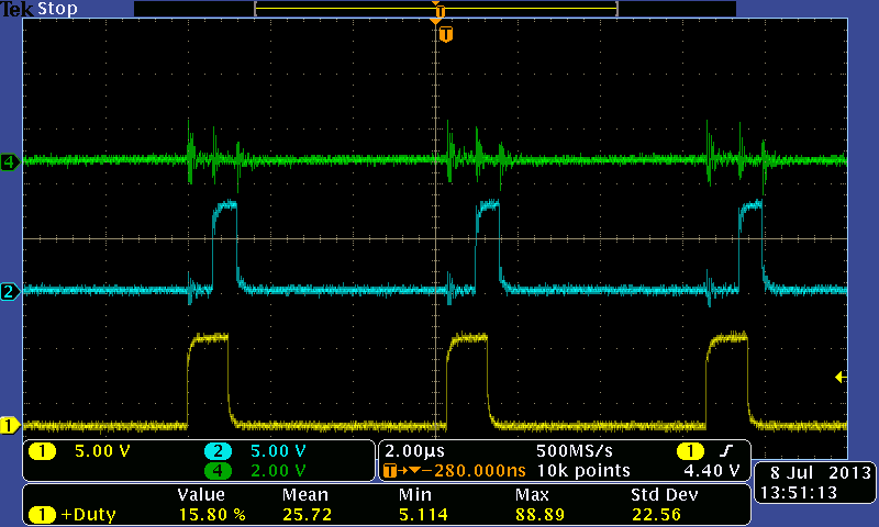

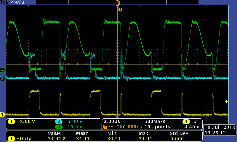

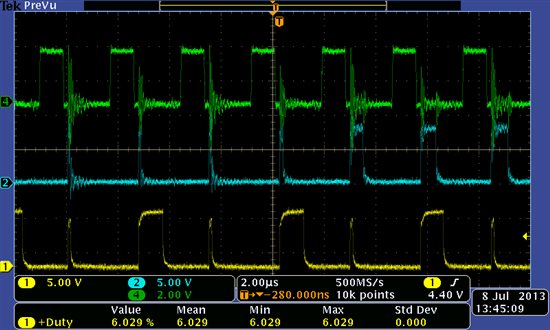

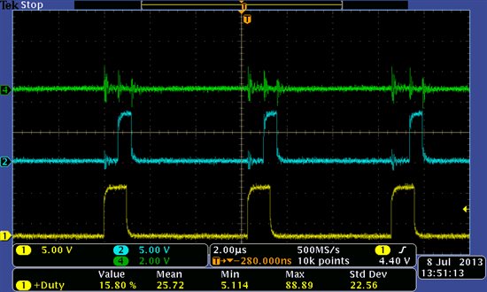

  • Anthony,
        I took a N-Channel MOSFET and connected it as a Source follower with the Gate going to a 5V Clock, the source connected to the Diodes (Anode with the Cathodes going to the RC pins on two TPS40210 IC's) through a 500 Ohm resistor and the Drain to Vin. Vin = +18VDC. The following screen shot is the two parts running Asynchronously:
    The Blue and Yellow traces are the Gate Drive for the two PWM's....as yu can see they are running at ~ the same frequency. The next screen shot is with the clock applied in Synchronous mode:
    Again the yellow and Blue traces are the Gate Drive pulses while the Green is the Drain for the Yellow trace side.....You can see that the frequency is much higher and both sides are synchronous but the gate drive pulses are not correct. the loads are identical for each screeenshot. Here is another screenshot:
    Here, the green trace is the Source of the MOSFET. It is a little more than +3V when high. I don't get why the pulse width is so inconsistent when I go to Synchronous mode........
    john

  • Here's a bit more of an explanation as to why the FET method actually does work. When free running, the TPS40210 oscillator uses both the peak and valley voltages to generate the control signals for the PWM latch.
    When the RC voltage reaches the peak (VDD/20) the TPS40210 will terminate the current switching cycle, even if COMP + ISNS is greater than the ramp.  This will also set the discharge latch on the oscillator to discharge RC to less than 150mV.  When RC is less than 150mV the PWM comparator is reset and a new switching cycle begins.
    When synchronized with a MOSFET, the PWM pulse can only be terminated by COMP + ISNS > Vramp and may remain ON during the discharge of RC if they exceed the peak of the ramp in synchronization, however when the 150mV comparator is set, it will terminate the current pulse, reset the PWM comparator and prepare to start a new pulse.  Since the external sync pulse will continue to hold RC low during the entire sync pulse, the “ON” time of the SYNC pulse (period when RC is forced below 150mV) should be less than half the minimum “ON” time for the application. A series capacitor and resistor to ground at the gate of the small FET so only a short pulse is used to turn on the FET and reset the RC signal.
