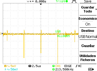

Hello, i mounted PCB with the schematic of application note pmp 2890. This circuit is a flyback converter with TPS40210 as controller.
i´m selected input voltage 24 v for output voltage 12v and load is 45 ohm for output current 270mA.
i adjust the switching frequency in RC a 150 kHz.
I have following the datasheet TPS40210, in the gate drive circuit (page 23), i have also replaced Rg. In the original design Rg = 20 kohm but as Qg=24nC in my mosfet,
Rg = 105 / Qg = 105 / 24 = 4,37 ohm
It´s much smaller than the original Rg.
The datasheet also recommended connect the third pin (DIS) a GND.
With this changes, and before the changes, output voltage is zero.
This changes are good for the circuit?

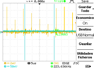

i think that the oscillator of TPS40210 don´t started and don´t trigger the mosfet. as I can check? as I can fix it and get the expected output voltage?
Thank´s.
  • Hi Luis,
    The original is 20 Ω (not kΩ) on the PMP2890 schematic so your new resistor is reasonable. Also as you mention DIS should be connected to ground to enable the part. These changes are ok.

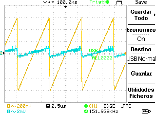

    Is the screenshot you have given of the RC pin for this same board? If so it seems like the oscillator is running. Are there switching pulses from the GDRV pin even though there is a ramp at the RC pin?
    Anthony
  • Yes the screenshot is in the pin 1 (RC), is the first thing I checked.
    After replacing Rg, in pin 7 (GDRV) i see the screenshot (the yellow line) :
    i don´t know as considered this signal but i think cannot trigger the MOS. I expected a square signal in this pin (GDRV) but I only see that kind of noise and don´t know if correct.
    In the original design use MOSFET Si4484EY but don´t manufactured now, i used his equivalent Si4056DY. The two mosfet are same manufacturer, vishay.
    Thank´s.

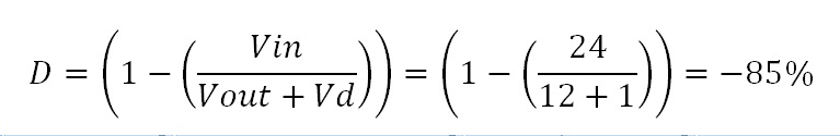

  • I continue looking at solutions. Here i will refer to page and equations located at datasheet of TPS40210.

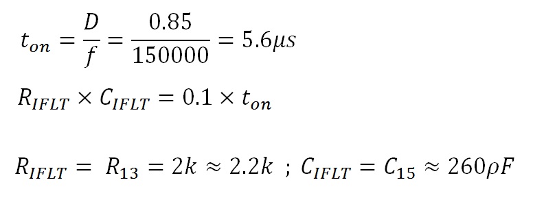

    Reviewing the datasheet for this circuit, in page 12, equation 2, the duty for continuous conduction mode is:
    i don´t know that mean the negative duty.
    And duty for discontinuous mode, page 12, equation 3:
    With these dates in page 16, Current sense filtering equation 11 and equation 12:
    C15 is 260 pF and not 100 pF, i don´t know go for the right track with this calculations.
    Why choose C15=100pF in the original design?

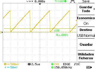

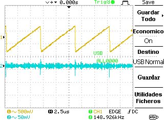

    I see now in pin 1 "RC" (yellow) and pin 2 "soft--start" (blue)
    The signal in this pins are expected, but Vout is zero yet. Another pins doesn´t has signal.

  • Hi Luis,
    A few comments. The equations in the datasheet apply only to a boost design. The design equations such as duty cycle will change for flyback and depend on the turns ratio of the transformer.

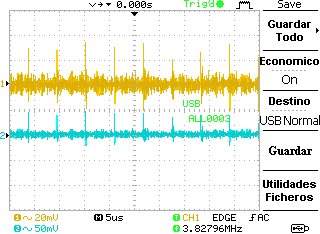

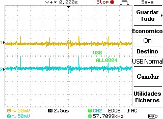

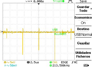

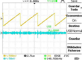

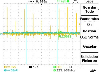

    For these three pins it would be better to see an oscilloscope screenshot
    For pin 1 RC and pin 2 SS, You can see the soft-start don´t work. I believe as has overcurrent, activate OC fault and don´t work the controller, but i don´t know as remove this error.
    For pin 4 COMP and pin 5 FB, the peaks are repeat qith 150 kHz more or less
    For pin 7 ISNS and pin 8 GDRV
    The other ins has signal without waveform.
    As I can solve the problem with overcurrent?
    I can remove the overcurrent measurement and protection?

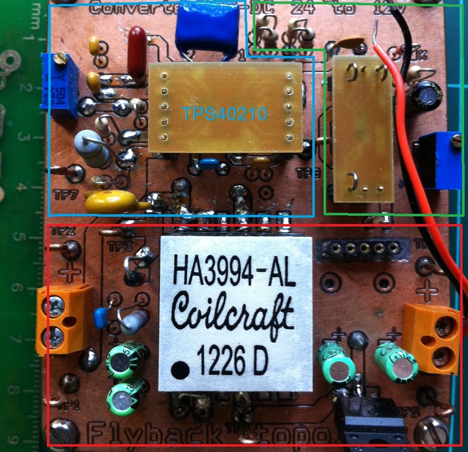

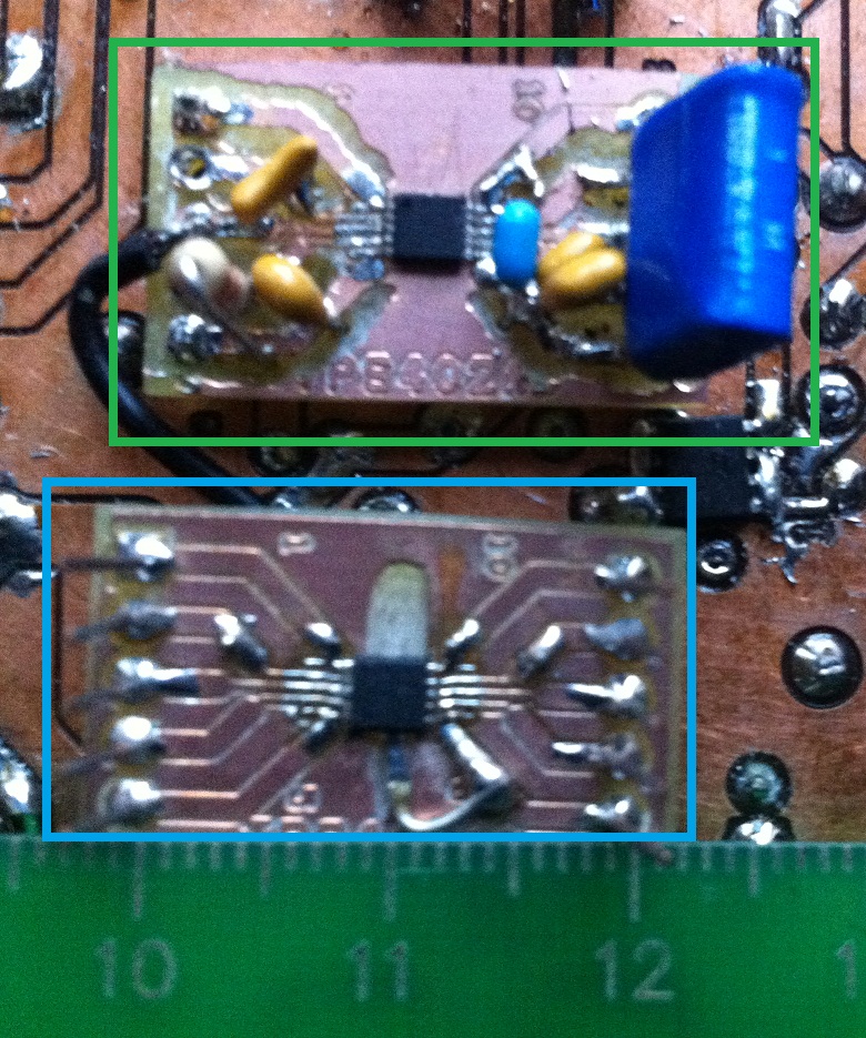

  • The layout is likely the source of your issues. Using this method for prototyping may be quicker and easier but introduces so many additional factors which can cause problems. The connections to the TPS40210 pins look very long which adds a lot of inductance. The increased inductance makes the part extra sensitive to noise. Is it possible to see the layout of the PCB near where the TPS40210 board is soldered onto it?
    Also the peaks being measured on these signals is likely noise from the RC ramp. The peaks line up with the falling edge of the RC waveform.
  • Also the peaks being measured on these signals is likely noise from the RC ramp. The peaks line up with the falling edge of the RC waveform.
    Yes, the peaks coincide with the slope of the sawtooth signal.
    Yes, of course. I chose to mount the controller TPS40210 on a pcb  extra because being so small I had troublewith the solder without breaking the PCB.
    In blue, the pcb with which I have done all the tests. In green the pcb modificated with capacitors very near of the pins.
    With modificated pcb (in green) for controller has lower noise but in pin 4 COMP and pin 5 FB has 700mV DC more or less. In pin 7 ISNS has 10mV DC before, (with blue pcb) has 180 mV.
    Any recommendation for pcb controller, or the capacitors are sufficiently near?
    Tomorrow probe more changes. I will mount parallel capacitors to lower parasitic inductance and prove new pcb.
