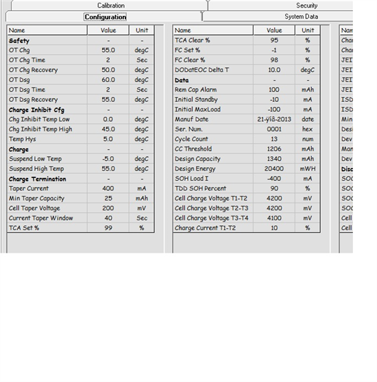

bq34z100 - flag "FC" is not set if "FC set% =-1"
Good day!
If you set the FC Set% =-1, the flag FC is not set at all.
 Though
- Average Current is < Taper Current
- Voltage > Charging Voltage – Taper Voltage
capacity > 0.25 mAh perCurrent Taper Window (it is not clear for me)
Explain what is wrong?
