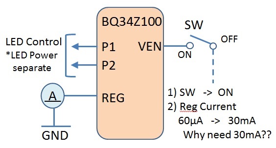

I have some question for BQ34Z100 Spen.
This device has LED indicater as Gage Staus.
Now Our sysytem use 10 LED indicator for Remain Gagae.
But we found this pehnomenon and dupulicate step 1 ) - 3)
Step 1)   VEN  ON
Step 2)  We messurement for Current  between  Reg and GND
Step 3)  Result  is  30mA   at   VEN ON        *   Normal  VEN  OFF  =>  60uA
【 Question 】
 Why current increased to 30mA  from 60uA ??
  Of course,  LED Power seperated  from this REG Power Line.
  Could you tell us about this reason ?  Dose thise device need  30mA Curent with LED Status ??
  Could you tell me  this REG current spec?
  Because of,  we dose not have this device Bloack Diagram and deatial.
Regard
Jasper
  • Jasper,
    We recommend placing a 1 kohm resistor in series with the switch connecting REG15 to VEN to limit the current. Please reference the schematic in Figure 7 of the bq34z100 datasheet.

  • Dear Tom
    Now  I used  BQ34Z100  EVM and measured current about this REG Current 30mA  Issues.
    【 Question 】
     Dose BQ34Z100 EVM has this 1k Ohm on EVM Board??
     Because of  I could not found 1k Ohm Resister at VEN on EVM.
     But Data Sheet schematic has this 1k ohm as R38.
    And  we need Reason for this phenomenon and  cause relation between VEN 1K Ohm and REG.
    I think this is some relation to internal function block .

  • Hi  Tom
    I checked  REG25 Current with  this Resister between 1K  and 10k Ohm.
    Resister Value(ohm)          REG2.5 Current (mA)
         0   ohm                                32.8mA
        1k  ohm                                4.25mA
        5K ohm                                2.38mA
      10k  ohm                               2.13mA
    We wants  Maximum Resister value for VEN .
    Because of we need save consumption current at LED Gage Status.
    Could you tell us about this Maximum Resister Value?
    Thanks and Regard
    Jasper
  • Jasper,
    I did not conduct the original analysis to select the resistance value. I an out of the office through Friday, but I will look at it next week. Also, the resistor was added to the newer version of the EVM. You must be using the old one.
    Tom
  • Dear Tom
    Thank you very much.
    We want to know just these one.
    1)   Why relation this REG25 Current increase with VEN  Resister setting (= Current setting ) ??
    2)   Could you tell us about VEN internal Function ??      Pushpull , or Internal Pull Down Resister value.... etc.
    3)   About this resister setting finale value decide by  High Level keep  minimum current for VEN.
         This mean  , almost device has V_IL , V_IH, I_IL and  I_IH spec.    I think need I_IH spec  VEN for this device.
    Any way can I contact  to you directory??
    Regard
    Jasper
  • Jasper
    My testing shows that the device requires 75uA to be forced into the VEN pin to be recognized as a high level and turn the LEDs on. That will limit the series resistance to about 33 kohms.
    Tom

  • Dear Tom
    Thank you very much about this Resistance and Current Value.
    But we need more some information about this Answer.
    Question
    1)  This VEN Port internal easy Block and Structure.  * What type input Port structure?
        Because of we need how to calculate about this Resister value with Min Current.
    Thanks and Regard
    Jasper
  • Jasper
    The pin has a totem pole output structure to provide gate drive to the external FET network that disables the BAT sense circuit when the voltage measurement is not in progress. The pin also have an analog input buffer and you have to force current into the pin to overdrive the internal low-side FET. The series resistance needs to be 33 kohm or smaller to overdrive the FET and actuate the LEDs.
    Tom
  • Dear Tom
    I understood VEN structure.
     Thanks and Regard
    Jasper in Japan
