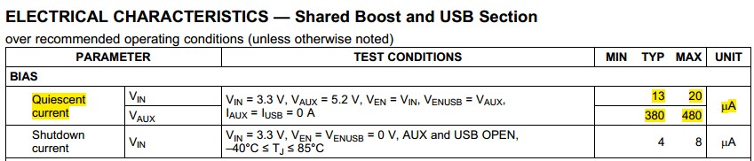

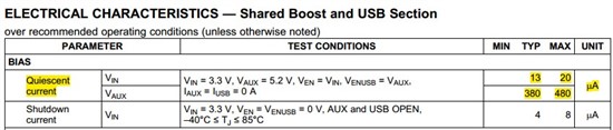

I can't complete understanding the Iq for TPS2501. VAUX is an output to USB pin. If the VAUX Iq is 380uA, the Vin Iq should be 665uA.
380uA*5.2V/90%/3.3=665.3uA, Vin Iq = 13uA+665.3uA=678uA. Am I right?
For this test, 5.2V is applied to AUX (no switching occurs) and 380uA (typical) flows into the IC. So, the AUX quiescent current does not flow into the IN pin for this case.
