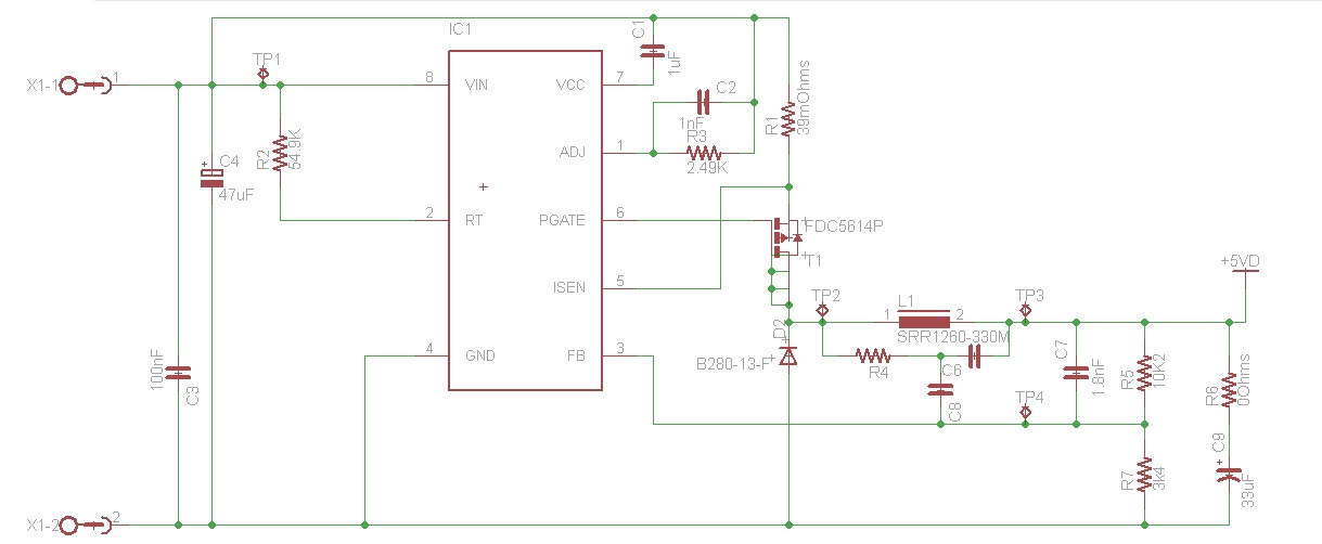

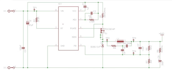

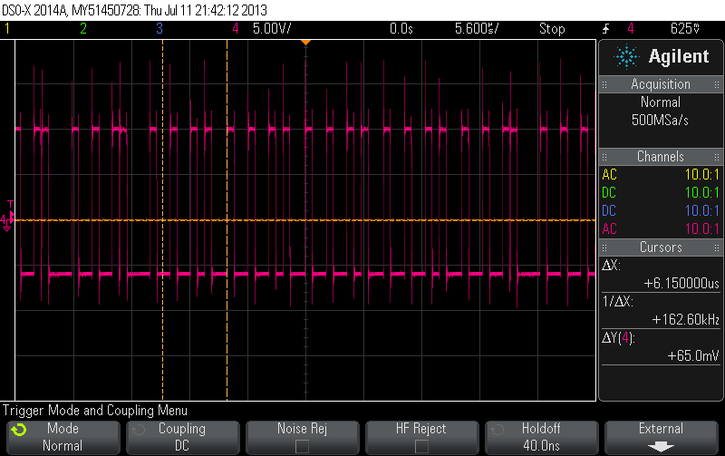

I have built a Buck regulator using the LM25085, to provide  5V output over an input range of 9-42V. I used the WEBENCH tool to get the correct circuitry.

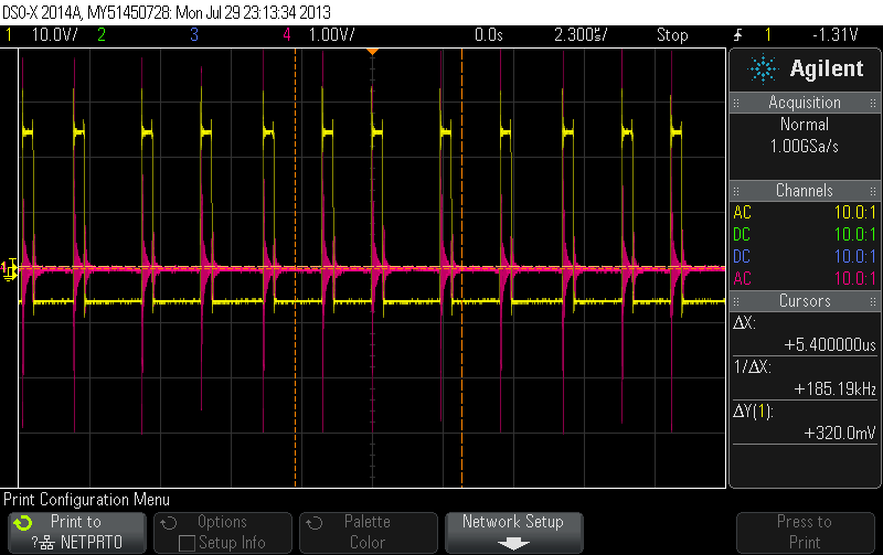

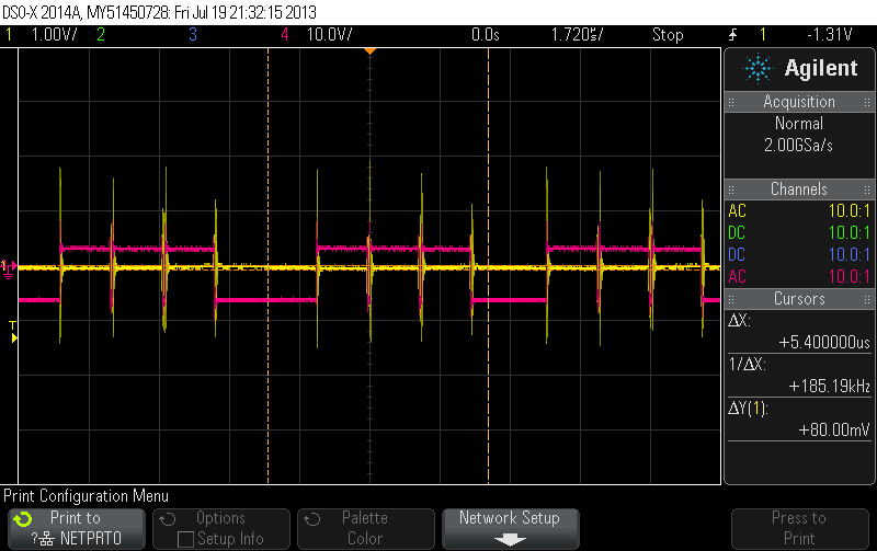

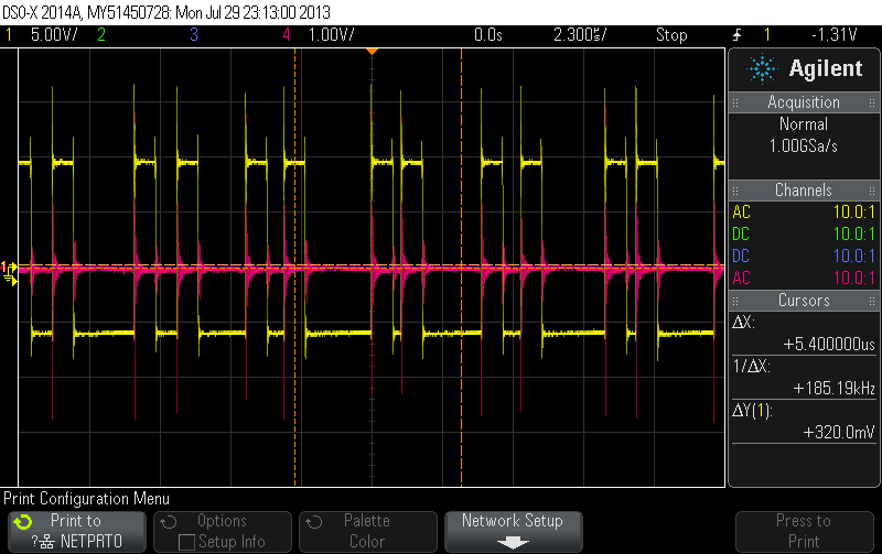

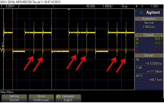

Right now that I'm testing the circuit I see something strange at the switch node. During the ON periodo the signal at this point will go to Zero volts two times.
I attach a picture to better explain what I mean with "strange waveform".
