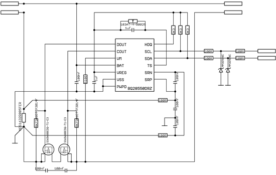

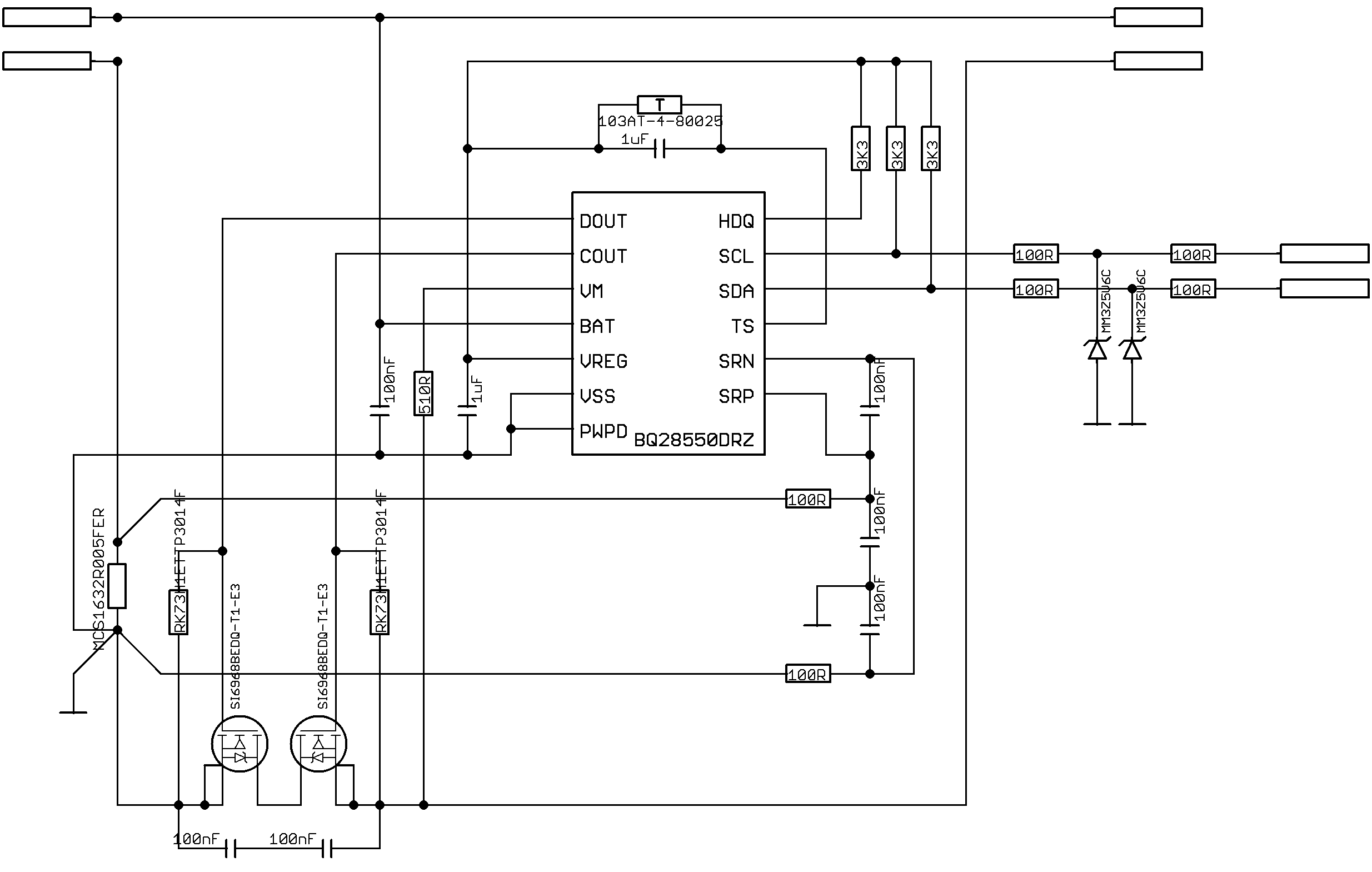

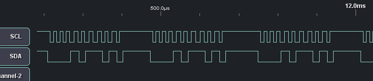

  • Thanks Onyx. This did not seem to solve the problem either. In the attached image, you can see the Logic Analzyer's capture of the signals into the bq28550's I2C bus. It transmits the correct address, followed by a 'read' bit, but does not receive ACK, and continually does this on a loop. Both the charge and discharge transistors are turned on at this point, and the bq28550 is powering the I2C Master:
    Also attached is our application schematic. As far as I can tell it matches all of the critical functions of the Reference Schematic, but please let me know if you see any problems:
  • Hi Brenton,
    Nothing on your schematic appears as an anomaly to me. Here is what I suggest you do:
    Connect your device to an EV2300 and connect to a computer. Download and install our EVSW for the bq28550 and check to see if you have communication with the device. On the EV2300, make sure the device is connected to the SMB port. If you have communication with the computer, then it means your devices are  ok.
    Also can you connect your lines to an oscilloscope intead of the logic analyser. This will enable us to see if your host is pulling the lines high when the chip is trying to pull it low.
    Your logic analyser image above shows the address is correct. Keep it that way moving forward. It's hard to tell from your logic analyser image, what the frequency of your I2C signals is. Can you let me know?

  • We have resolved the issue now; our pull-up voltage was different from the bq28550's. Onyx, thank you for all your help.
