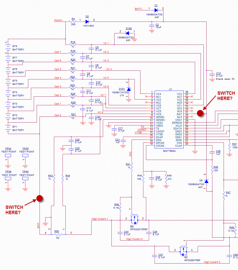

I will be flying a BQ77908 battery pack on a high altitude balloon mission where a single event upset may latch up the device.  Where is the best place to put a MOSFET switch in order to cycle the power to the BQ77908?  I could place a MOSFET switch on the BAT pin of the device to cycle the chip power, but this would leave the battery still connected to the VC device pins.  Alternatively, I could disconnect the BATT- terminal of the battery pack from ground.  I have attached a picture showing these two locations.
What is the best approach to cycle the power to the BQ77908 in order to clear any very high altitude single event latch up effects?
