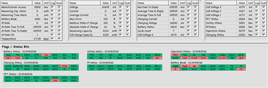

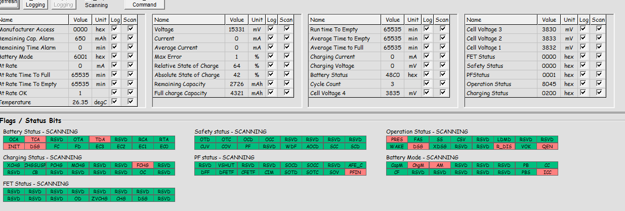

I have encountered PFIN fault after I failed to program the .dfi file before i prepared to perform learn cycle for Panasonic battery pack. I had sent SMBus Command: 00, Word 1: 2673, Word 2: 1712 to clear the fault but it fails. The flag will set again after i refresh the SBS page for a few times as shown in screenshots below.
PFIN fault still exist:
Is there any other method that can be used to solve this issue?

    Your PFstatus shows that the PFIn bit is being set indicating that the external protection device has blown the fuse due to a fault occuring. Are you using our EVM for this assesment or are you using your board? The FET that triggers the fuse is being turned on, thus pulling PFIN low, so even if you clear the pf as long as Pfin pin is still low due to the external device, ththe PFIN bit being set will keep returning. Check your bq294XX device to see what's causing it's output to trigger the FET that's causing the fuse to blow.
    As an alternative, if you do not intend to use this functionality,  you can set the PFIN detect time to zero to turn this feature off.

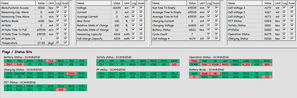

    I have another battery pack with SCD fault after it has been fully charged and been in relaxation for more than 2 hours while I'm running Impedance Track fuel gauge accuracy test as shown in below. May I know the proper method to clear this SCD fault?

    There was a short circuit discharge condition that occured that's why the SCD bit is set. Issuing a command 41 resets the device and clears the safety status register including the SCD.

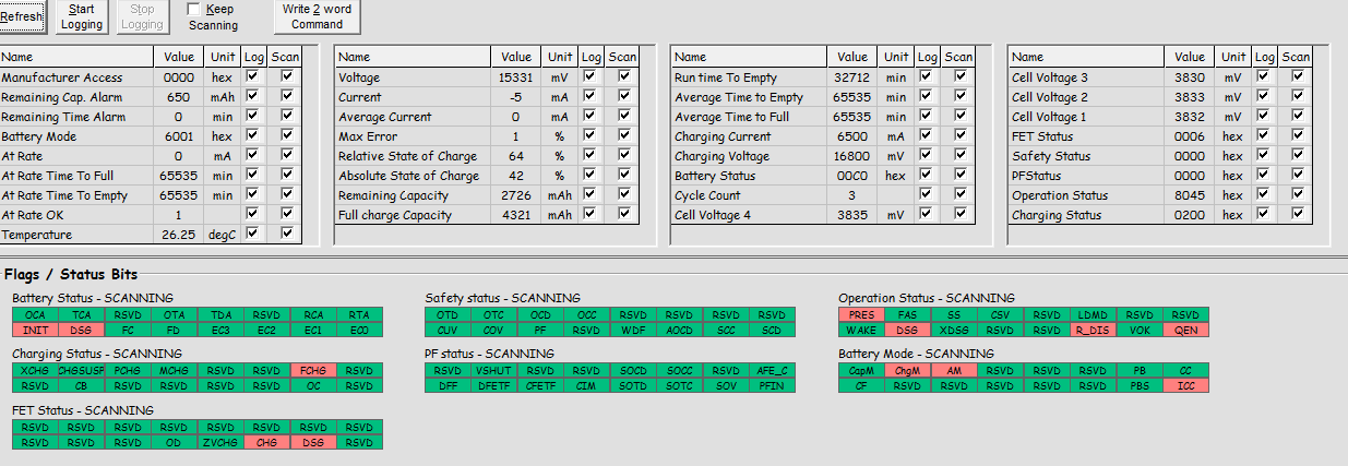

    Here I encountered another issue while performing the learning cycle for bq20z75-v180. The battery capacity has been updated close to the expected value but the update status changed to 0x0A instead of 0x06. Does this indicate the learning cycle has not completed yet?

    A Update Status = 0A is very unusual. It would indicate that Qmax has been updated two times, the Ra-table has not been updated and IT is no longer enabled. What learning cycle process did you use? Can you describe your process?
