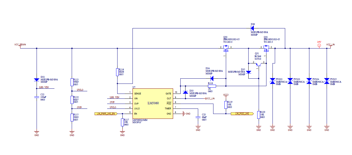

I have designed a PCB with the LM5060 to protect against over current and over voltage. During testing we have found that when we apply a short circuit the LM5060 does not turn OFF, then the FETs then over heat and blow up. The nPGD pin does show a fault when a short is present so my next approach was to see if turning OFF the EN pin if the nPGD pin goes high would be quick enough to save the FETs, unfortunately after performing this test the LM5060 blew up. I have repeated the test on another PCB and the same problem occurs.
I am using the datasheet recommended design described as "Application with Reverse Polarity Protection with Diodes for OUT Pin Protection" except Rsense is set at 16kOhm for a 20A protection based on using 2x IPB100N10S3-05 FETs. If apply a load of >20A then the LM5060 latches OFF and functions correctly, only when a hard short is present does this fault occur.

  • Hi, could you send the LM5060 portion of your schematic so further internal review can occur? How did you confirm that LM5060 was not turning off it's output? Did you monitor GATE and GATE was not low or are you looking at OUT? It might be that the FET(s) "blow" shorted drain-source first which would not allow OUT to pull low.
  • The LM5060 portion of the schematic:
    When the shortcircuit is applied the OUT still has a voltage on it.
    There are two issue here, No.1 the LM5060 does not turn OFF during a short, No.2 when you use nPGD to determine if OUT is ok and if it isnt, turn OFF the LM5060 blows up.
