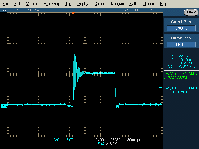

When I look at the voltage at pin SW, with almost no load (some logic plus the 680uF capactiors), we see a clean step waveform
But when we apply any load (by the moment a resitive load, plus 680uF capacitors), we can see some kind of oscillation, that we think it doesn’t be there
And zoomed

Is this oscillation undesirable?
any clue on what is causing this oscillation?

    You will usually see some ringing on the switch node.  In many cases the ringing won't cause any problems.  However, excessive ringing can sometimes effect EMI performance or be a sign of layout or noise problems.

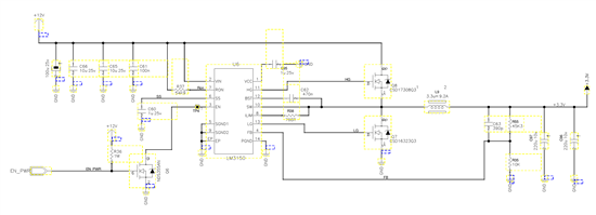

    This is the actual schematic for our DCDC:

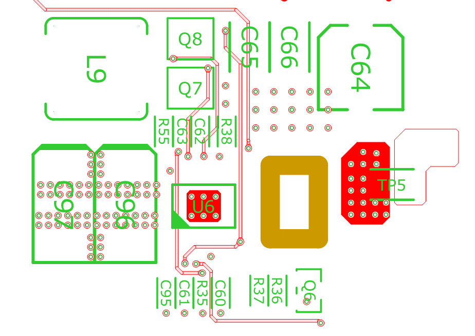

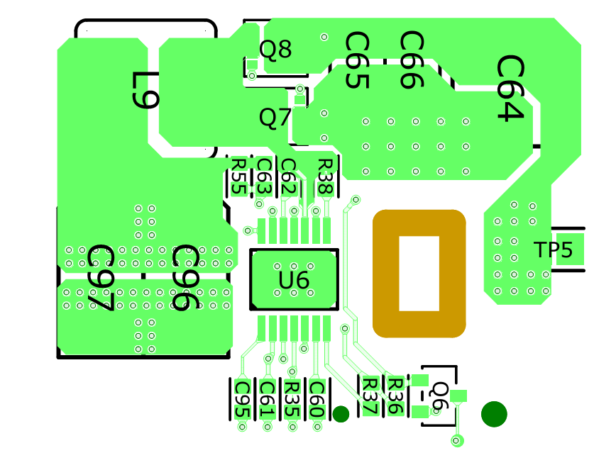

    and the corresponding layout:
    TOP layer
    and Bottom layer, with TOP components outlines superimposed:
    It's a four layer board, but L2 is GND plane and L3 is +3.3V + 12Vin planes.

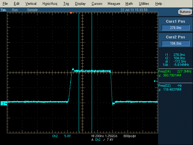

    3) A) add a snubber. I tryed some caps until Oscillation frequency is four time lower. This Cap was 10nF, then add in a series resistor (i tried 2 Ohm)
    It works but, i think it consumes too much power. If i am correct it is:
    P = C* Vin^2*freq = 10e-9* 144* 500e3  = 0.72W
    3) B) add a 1-10 Ohm resistor in series with Q8 gate to slow down the transition. I tried a 10 Ohm resistor with no apreciable change in the oscillation.

    A quick look at your layout.  It looks pretty good.  So I think we can rule out ground loop and layout as primary causes.  That leaves us with a very fast turn on of the FET.

    1)  The ringing frequency is around 120Mhz.  Can you place an 1000pF 0805 COG ceramics capacitor on the input as close as possible to the FETs. Place it to the left of C65.  This cap will have a resonant frequency around 130Mhz and it might with the ringing.
    2) There is a higher QG version of the FET the CSD17304.  This should have a slightly slower turn on speed and might reduce the ringing.
    Also you could try reducing the snubber capacitance to save on the power consumption.  This will be a balance between the power dissipation you can accept and the ringing. As I said before, some ringing is acceptable as long as the part is regulating correctly.
