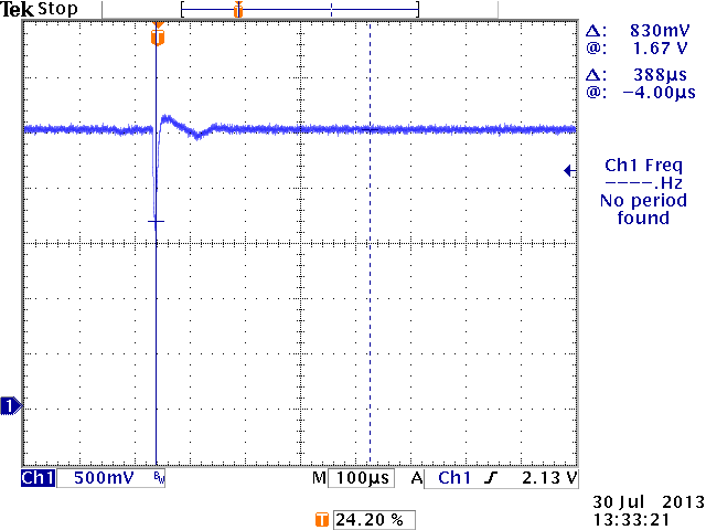

When I solder a Semitec 103AT-2 (10k ohm) thermistor on my BQ28Z560-R1 based fuel gauge/protection circuit as depicted in the reference design, the IC no longer responds to commands via I2C.  This failure occurs when the thermistor is attached before the cell.  If the thermistor is attached after the cell, then the system works fine.  Disconnecting it restores communication.
VREG reads 2.5V in both cases and I can find no board faults.  The FETs appear closed and current flows fine.
I am using the EV2300 and bq Evaluation Software for the Z560 with I2C lines pulled-up to 5V.  Chip is identified as version 0.05 by the software.
Has anyone else seen this behavior?
Thanks.

    Performing the wakeup with a resistor (and the EV2300 disconnected) results in the same behavior (and current draw) as when the EV2300 attempts to communicate.  In the above directions, the EV2300 was disconnected.  If I start the board with the EV2300 and the thermistor detached, then the EVSW correctly detects the device.  Although I then have to enable the 5V load source to continue since the I2C pullups are pulled to this switched rail.
    No, I do not have an EVM to compare against.
    With the thermistor attached, the VREG line drops low every 260ms in an endless loop at powerup.  The TS line (first image) shows the period and the VREG line (second image) shows a closeup of the VREG pin when the twitch occurs.  When the thermistor is detached, this glitch occurs a few times during the boot sequence before dissipating (each time it is a little smaller).
    I swapped the 0.1uF cap recommended in the datasheet for a 1uF.  The system works as expected now.
  • Hi Onyx and Iderhn,
    Upon reading this last post, I took a peek at the schematic for the EVM and the typical application schematic for a CFET in the data sheet.  There is a discrepancy between the two schematics.  The EVM schematic does in fact have a 1uF cap to on the VREG line where the data sheet schematic shows a 0.1uF on VREG.
    So, Onyx, I suspect if you swap the 1uF cap on your EVM for a 0.1uF cap, you will be able to make your EVM exhibit this behavior.
    I was also able to get my device working by making the cap change.  Thanks for the discovery Iderhn!
    Eric
  • Aha! That makes more sense now. I was wondering why your boards didn't work if they were a replica of our EVMs. good find Eric!
