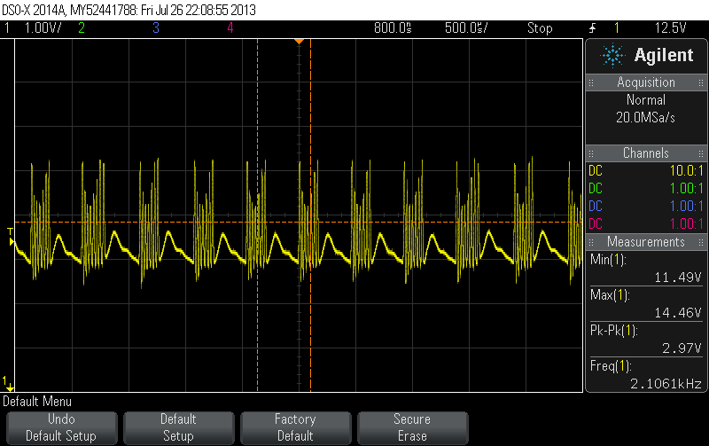

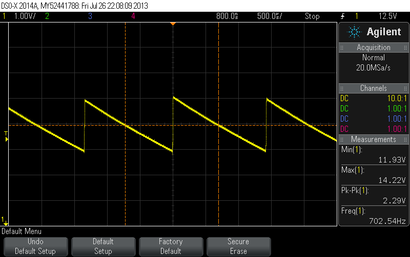

LM3478MM boost has 6khz sawtooth output
I am using a LM3478MM in boost configuration.  Input range is 4-14 volts output is 12 volts.  The purpose of the regulator is to maintain a minimum voltage of 12 VDC from a 12 volt lead acid battery.  The problem is when the input voltage is above ~8 vdc.  The output switching frequency drops from 600 khz to about 6 khz.  The output voltage remains at 12 volts when this happens.  The regulator seems to otherwise function however there is an annoying audible whine and the output waveform is a sawtooth with about 1 volt ripple.
Is this problem caused by the OVP circuit or could it be related to compensation? or something else  when the input voltage is decreased to <8 vdc the regulator behaves as expected.
I would like to avoid going to a SEPIC strategy to reduce cost.
