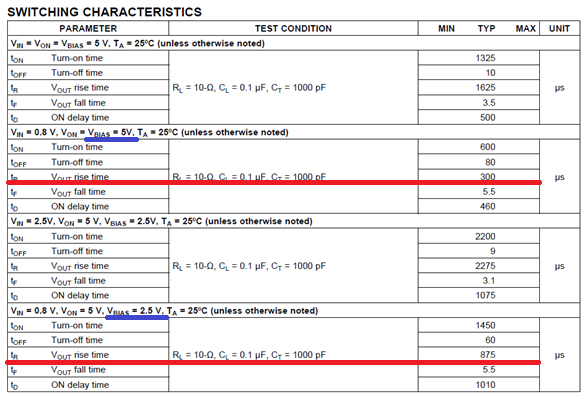

The following figure shows the Data sheet P.5 「SWITCING CHARACTERISTICS」.
TR value of the red line part is different.
I think the difference of the two values​​ VBIAS value condition.

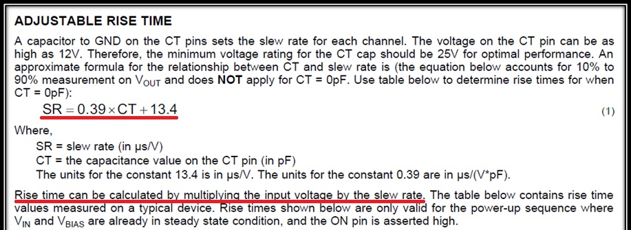

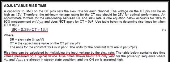

The following figure shows the Data sheet P.17 「ADJUSTABLE RISE TIME」.
It is described as 「Rise time can be calculated by multiplying the input voltage by the slew rate.」 is here.
But VBIAS is not taken into account.
Is there a method of calculating the tR considering VBIAS?
