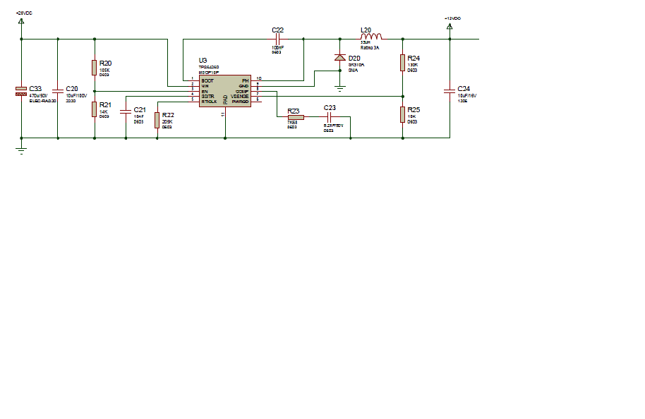

Anyone can help me please, from where I can get TPS54260 model  + necessary library files  for the purpose of step down DC-DC converter. (had one model downloaded from TI side but it is with 5 pin, is it possible to get 10 pin model ), Any idea?
Problem with TPS54260 while using it as DC-DC converter. Takes DC input of 28V and designed to give 12 V DC as output. But  the output is not perfect. 12 v DC output  have some noise / oscillation while analyzing output through oscilloscope.
How  I can rid off this problem, any idea?

  • Can you post your schematic and some waveforms that show your problem?
  • This is the only schematic file I have and soldered board is burned out, unable to get wave forms again . TPS54260  raised its temperature last time with attached schematic diagram  and burns out.
    Here:
     C33 = 470 uf
    C20 = 10 uF
    R20 = 105K
    R21 = 14K
    C21 = 10nF
    R22 = 205K
    C22 = 100 nF
    R23 = 7K68
    C23 = 8.2 nF
    L20  = 33 uH
    R24 = 130 K
    R25 = 10K
    C24 = 10 uF
