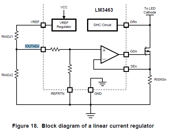

    Figure 18 in the data sheet shows the linear current regulator.
    Knowing the method of using the IOUTADJ function from the datasheet details, it is possible to vary the divider voltage based on an external temperature.
    One example would be a 10K NTC thermistor in parallel with RIADJ2, as temperature increases the NTC will decrease and lower IOUTADJ.
    You could even pull IOUTADJ so low it could shutoff the LED current at high temperatures.
    Even if you do not use dynamic headroom, the LM3463 will function with current regulation AND INTERNAL thermal foldback of the IC junction temperature.
    Without dynamic headroom control, you can not minimize the heat of the mosfet pass element, thus no thermal control in that aspect.

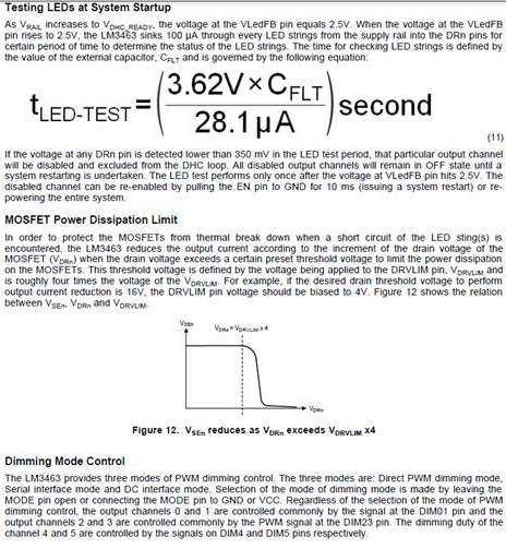

  • LM3463 can work as output sinks without DHC (dynamic headroom control), provided that:-
    1. OutP is open so no feedback to primary supply for DHC;
    2. VLedFB needs biased higher than 2.5V to enable linear regulators (refer to DS session “Testing LEDs at System Startup”);
    3. Make sure VDRn never exceeds 4 x “bias voltage at DRVLIM pin”, or the current will be cut down to save the power dissipation of the powerFET (refer to DS session “MOSFET Power Dissipation Limit”)

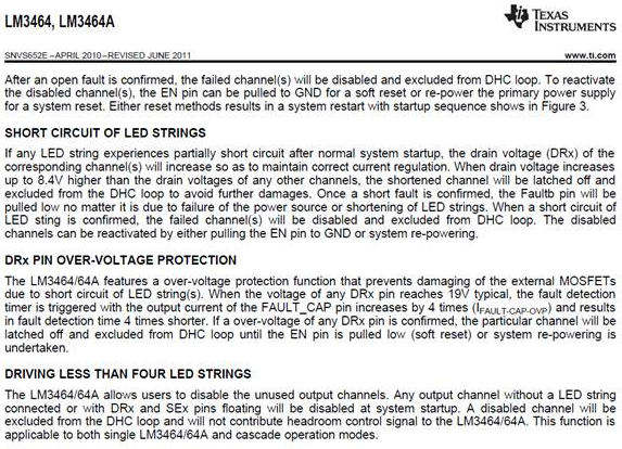

    LM3464 can work as output sinks without DHC also, similar to LM3463 provided that:-
    2. VLedFB needs biased higher than 2.5V to enable linear regulators;
    3. Make sure VDRn < 8.35V, otherwise, the channel will be latched off due to short-fault (See DS sessions “SHORT CIRCUIT OF LED STRINGS” and “DRx PIN OVER-VOLTAGE PROTECTION”);
    And, LM3464 is doing analog-to-PWM for thermal foldback, see DS “THERMAL FOLDBACK INTERFACE”, “SETTING MINIMUM THERMAL DIMMING DUTY CYCLE” and “PWM DIMMING”.
