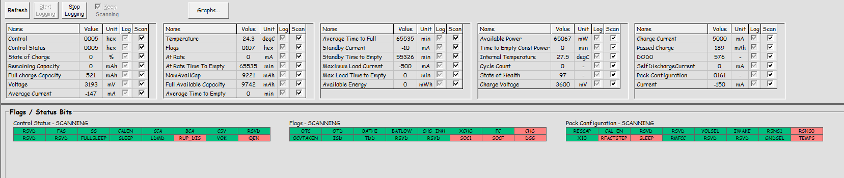

I just bought the BQ34Z100EVM to monitor my 3.2V 10Ah LiFePO4 battery. I set the chem to ID 0415 (It is not the same manufacturer as the battery I have but same Ah), the Qmax Cell to 10000mAh.
I am having issues with this board.
1) If the battery goes below 2.8V the flags SOC1, SOCF become red and remaining capacity becomes 0 and full charge capacity becomes some kind of arbitrary number. With these flags on and the battery is being charged the SOC1 and SOCF flags stay on and remaining cap and full charge stay the same. They won't read properly anymore until I unplug the battery, do a 0041 (reset) then plug it back in. Afterwards the numbers are correct.
2) I have a load between 160mA to 700mA on the battery, the average current is correct remaining cap and full charge cap are correct at the beginning. After some time, something happens and I have 2 different scenarios.
1) Full charge is correct, remaining cap is a very low number and incorrect. Looking at the log there was some error then remaining cap value became incorrect
2) Full charge becomes some arbitrary number and remaining cap becomes 0
3) if I do a 0041 (reset) function while the fuel gauge is monitoring the battery, I get incorrect remaining cap and full charge cap values.
4) Passed Charge seems to be resetting itself as well. What is this value supposed to represent?
Attached is the excel file, please look at row 3415.
2185.run_down_V2.xls

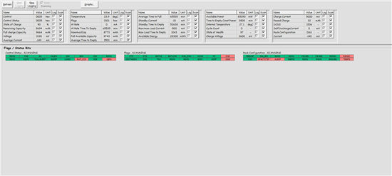

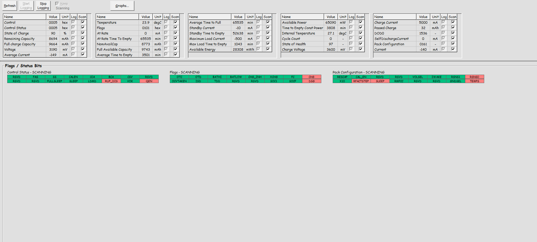

I also attached two pictures of the program reporting correct values for remaining cap and full charge and another picture when it goes bad.

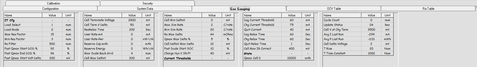

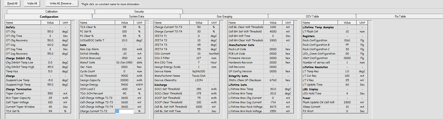

Below is the configuration section and the gas gauge section.
Cris
  • Cris
    Can you export a gg file from your pack so I can check the parameters?
    Tom
  • How do I export a gg file?
    Cris
  • Cris
    You can go to the Data Flash screen, press the Read All button, go to the File pull-down menu and export the gg file.
    Tom
  • Thanks Tom, attached is the gg file. You will have to rename the extension to "gg".

  • Cris,
    I have reviewed your log file and gg file and have a few questions.
    • Is the current calibrated to 1X? If so, there is a lot of drop in this cell for a discharge current that is less than 500mA . What discharge current do you plan to use in normal operation? Why is the current varying during the optimization cycle?
    • Was the cell fully charged before starting the discharge? The FC bit is not set in the Flags register.
    • I would set the Flash Update OK voltage to 2V for your setup.
    • I would disable FConvEn in the Operation Configuration B register during the optimization cycle.
    • What happened at line 3415 in you log file? It looks like the device may have been reset.
    • What is the part number for your cell and how did you select ChemID 415 for the setup?
    Tom
