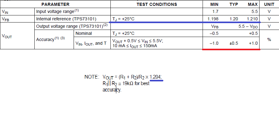

    Do you become the accuracy of Vout if taking into account the accuracy of the variable resistor to the 1%?
    1% (accuracy) Is it value in consideration of the Internal reference part of the blue line?
    Yusuke,
    We have obtained questions of  TPS73101 from our customers.
    ➀Can you tell me the internal reference voltage accuracy of the TPS73101 in Over temperature range “-40 to 125℃” ?
    ➁The following figure shows the Data sheet P.3 「Vout Accuracy」.
      Is output voltage accuracy  value in consideration of  Internal reference accuracy?
    Yusuke,
  • Yusuke-san,
    The accuracy for Vout includes the internal reference accuracy.  Over the entire temperature range (-40 to 125 deg C), the accuracy of Vout is within 1% as shown in the table snippet you posted.
