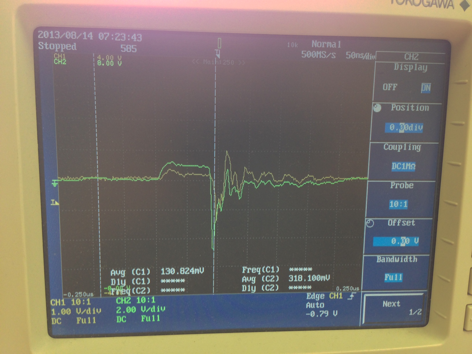

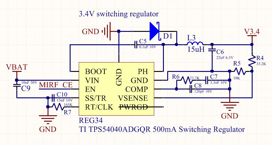

I have assembled (using the TI design tool) a TPS54040A-based switching circuit with 3.4-3.5V out.  I have built two boards and checked all of the components and connections on them, and I am seeing the same result on both - when EN is held low the device is very much off and drawing no current; when I switch it on (with 15V in) it draws 70-100mA and outputs little 0.4V bursts on the output line every 12us or so.  I'm not sure what is going on here - any thoughts?  Schematic and scope output below.  D1 is MBRA340T3G, L3 is TDK VLCF4028T-150MR88-2.  Thanks!

  • If you have no load connected you are operating in pulse skipping eco-mode.  try attaching enough load so that you are operating in DCM .  You should then have a regular pulse train on the PH node.
  • Hi John,
    Thanks for the response.  I have tried this with no load, a 200 ohm load, and a 67 ohm load with the same result.  Isn't this supposed to be able to handle a few hundred uA load anyhow without losing regulation?  Thanks.
    Is there any more information I can provide to get to the bottom of this problem?  Any idea what it might be?
  • Eco-mode threshold is somewhat unpredictable.  You can monitor the COMP pin voltage to see if it is clamping at the low end (around 500 mV).  68 ohm is still pretty light, try 10 ohm.  That should put you well into normal operation and CCM.
  • Looking at your schematic, it looks like there is a drawing error that might be causing the Soft Start capacitor to be shorted out.  That would tend to prevent startup.
  • Hi Marc,
    I'm a bit confused by your comment ... I see C10 of 15nF going from Ground to SS/TR pin.  Isn't this the intended configuration?
  • If you look closely at the schematic, you can see that there is a black line across the plates of the SS capacitor.  This is probably a piece of net wire that was drawn incorrectly.  It may (or may not) be shorting out the capacitor.  To know for sure you can check the netlist, layout, or measure the resistance on the board.  On reflection, probably a short would have been caught in layout, so this is probably a red herring.  But ironic since it would seem that it might cause the behavior you're seeing.
    Otherwise, it looks like maybe it is trying to start up into a short circuit?  Check the resistance at the output with power off.  Also check that the catch diode is not reversed--that might cause the effect you are seeing.
    With power on, check the voltages/waveforms on all the pins, make sure they all make sense.
    Good luck!

    Thanks for the info.  The black line was indeed a drawing error but didn't make it into the circuit.  Here is the scope trace of the output and the COMP pin (green) - both have the same ground reference and scale.  I have verified the output is not shorted.  The catch diode looks correct as well.  Any thoughts?
    Is there any other information I can provide to get to the bottom of this issue?  I'm not sure what the COMP pin output in green above is supposed to be telling me...
  • If I read that correctly, Vout is near 0V, and COMP is about 1.7 V.  With Vout low, COMP is (and should be) railed out at 1.7 V.  That should be commanding a high duty cycle.  What is the BOOT voltage?  If it is not 6 V or so above PH, then the highside cannot turn on.  What is SS?  If it is low, then it will not start up either.

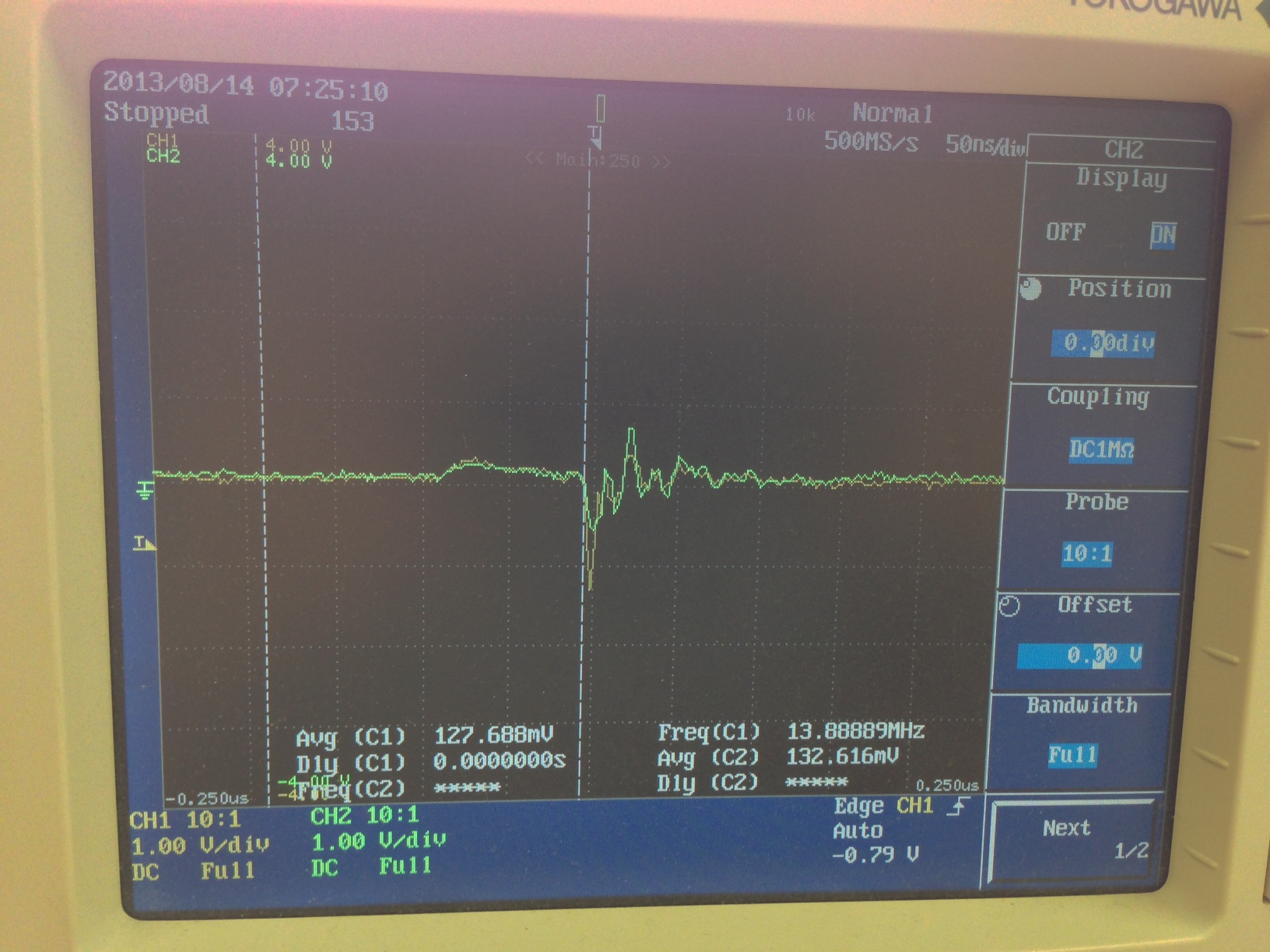

  • BOOT pin is green, referenced to ground
    PH pin is green, referenced to ground
    SS pin is green, referenced to ground
    Looks like BOOT is coming down pretty hard at the switch attempt?  I have 0.1uF spec'd, with my meter I am reading an actual value with power off of 93.5nF, which sounds like it should be OK?
  • It looks like the SS pin is at zero volts?  That would keep the chip from running.  Measure the resistance from SS to ground with the power off.  Use the scope to watch that pin as either power is applied or the EN pin is brought high.
  • Hi Marc, thanks for the help.  SS to ground is 1Mohm+.  Scope trace is green above at power-on.  Looks like it's going up to 0.45V or so and then coming down to rest around 0.1V.
  • It looks like it is trying to start but then shuts down, perhaps due to overcurrent.  Check to make sure that the EN pin is solidly high the whole time.  And are you absolutely certain the the diode is not backwards?
  • I don't think over current can cause a shutdown, but is has been a couple years since I last looked at this device.  Yes check EN and VIN to make sure you are not tripping UVLO.  Then you can try manually raisin SS with an external supply.

    If I reverse the diode, I get 10V on both SS and EN, and 0.7V approx output.  This is not exactly what I expected for 'correct', but looks better, so I looked into the issue further.  And bam, apparently I'm an idiot.  I took the TPS54040A pin 1 marker as the diode marker...  That's what I get for cramming everything together.  See here:
