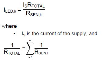

I want to power separate LED strings with 700mA each (X3) from a single 2100mA constant current source. However, I Rtotal is not defined in the datasheet. Here is the formula I am trying to manipulate:
ILED,k = ISRTOTAL
                 RSEN,k
Where: ILED,k = 700mA, Is=2100mA.
What is Rtotal?
Thanks!

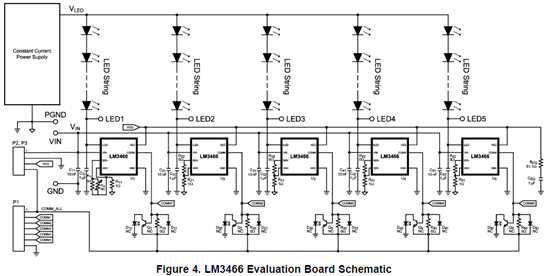

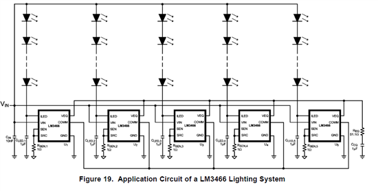

  • Cory, Rtotal is the sum of the Rsense, each LM3466 drives a string, has its own Rsense.
    In the case below from the data sheet, you have 5 LM3466, each with a 1 ohm, so 1/Rtotal = 1/5
    I(s) is the current needed to be provided by the main power supply source.

    My design utilizes 3 LM3466 ICs. Is is 2.1A and Iled is 700mA. I have tried to calculate  the value of Rsense using the formulas but cannot. The ratio of Rtotal/Rsense should be .33, but that would require Rsense being greater than Rtotal. What am I missing here?

    From the data sheet page 12:
    To set the LED current of all 5 LED strings equal, the sensing resistors corresponding to all 5 LM3466 are equal.
    It is recommended that the nominal voltage of the SEN pin VSEN should be around 0.3V.
    Therefore,
    RSEN is selected to be 1Ω. As a result, VSEN should be 0.35V if the LED current is 0.35A.
    So for yours all 3 would be equal value.
    For 0.3V at SEN and 700mA, R=0.35/.7= 0.5 ohms.
    Makes sense for 2X 350mA you have 1/2 the R.
    This goes as resistors in parallel. That's what your are missing, each individual R will be greater than the parallel total.
