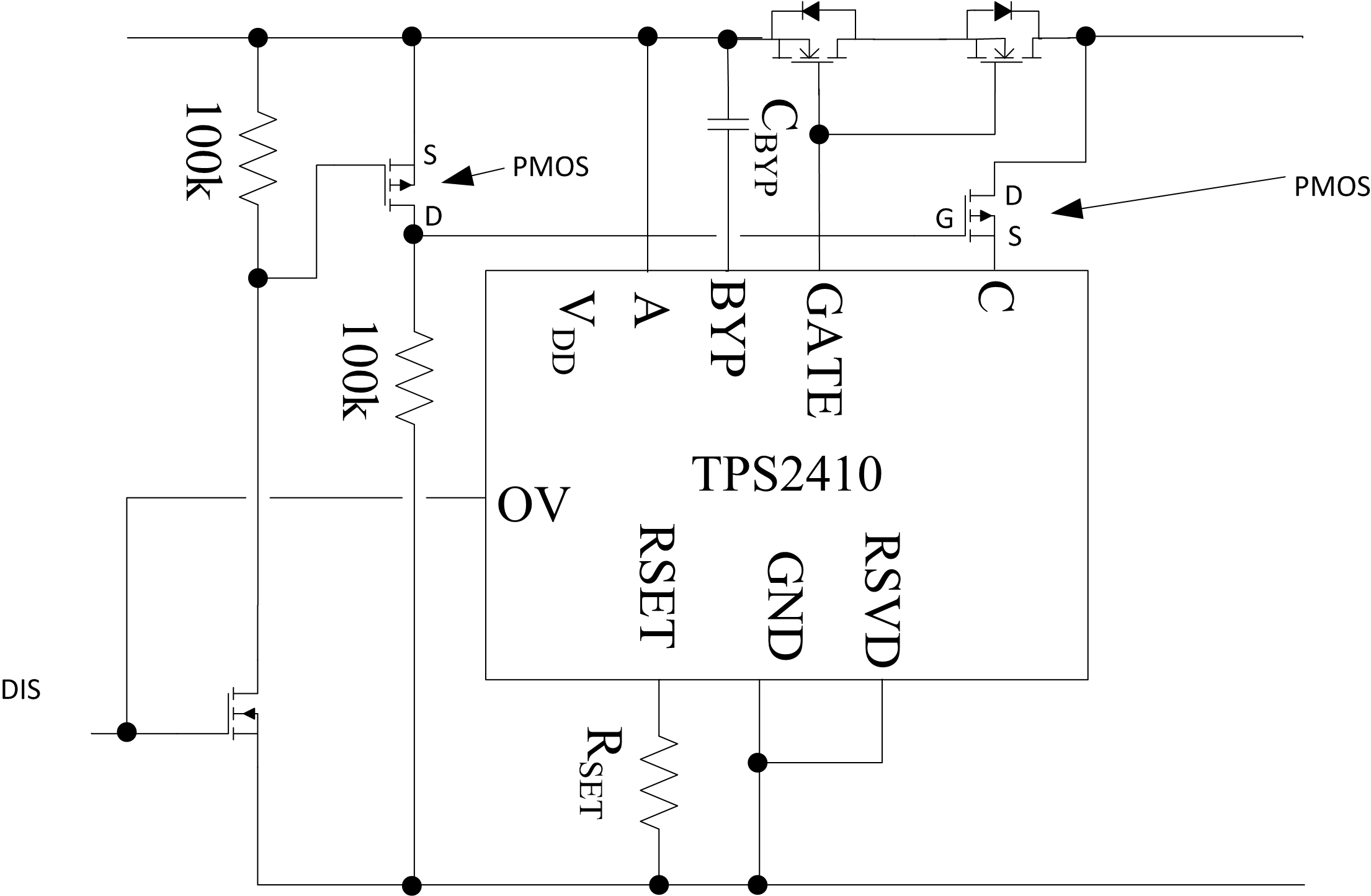

    You are correct there will be a leakage current of roughly 1mA towards the output. If the bus has no load it will float up as you notice. You have 2 options:
    1) Add a dummy load of 1k-ohm on the bus.
    2) use 2 logic FETs to disconnect C from V_bus when the ORing controller is disabled. As shown in the diagram below.
    As a side note, you never posted the attachment.
    -Artem

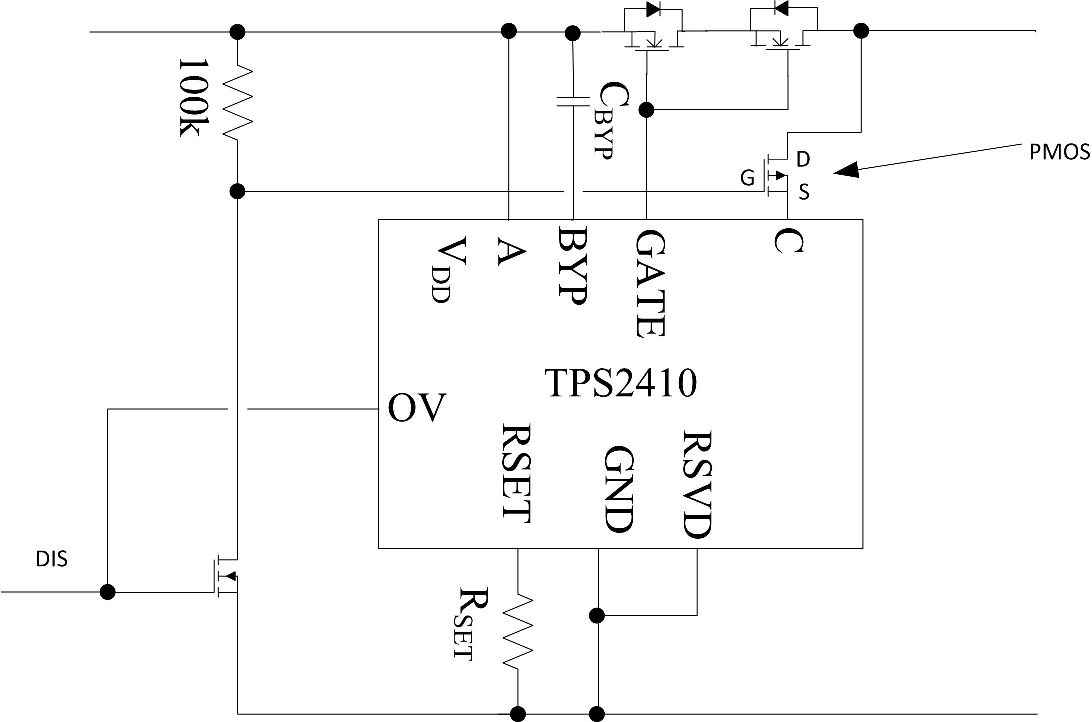

  • Sorry the polarity on that diagram was not right. Please refer to the one below:
     -Artem

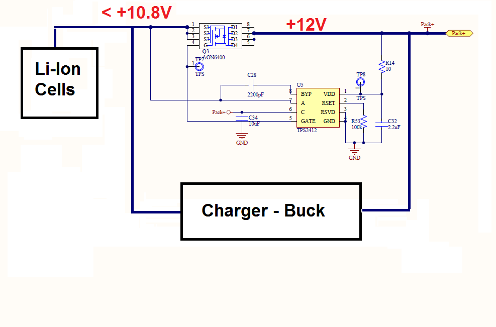

  • Hi Artem,
    The responses here focus on leakage through the C pin. My concern is leakage through the A pin. When Vac <= roughly -1.8V, electrical current flows out of the A pin. It appears that the feed for this current is through the VDD pin.
    My application is a OR-ing control on the output of a lithium-ion battery pack. The charger circuitry is on-board the battery pack, and placed in parallel with the output OR-ing control. The typical state of the TPS2412 is to have +12V available on the C pin, and cell stack voltage on the A pin (+10.8V when charged, for this pack). When the charger is disabled, the cells continue to charge due to leakage through the A pin. This charging is on the order of ~600uA worst noted case, to a voltage equal to C voltage (+12V) - 1.8V.
    If you view the data table found in the original post, you will see this issue in record.
    Please recommend a workaround or supply a specification for the A pin leakage characteristic.
    Lucas

  • Lucas,
    I understand your concern. I am a little surprised by the current on C being ~1.25mA.  I will check this with the designer and dig into how big the sourcing current on A is supposed to be.
    In terms of a work-around hooking up A to Vdd or adding a "dummy load" with a series FET (driving by the OV/disable signal) are the best I can think off.
    After thinking it through I don't think that disconnecting C from the source of the ORing FET is a good idea, b/c the charge pump voltage is derived from A and it needs to be tied to the source.
    -Artem

  • Hi Artem,
    I can see where this thread is a bit confusing. The initial poster of this, David Schmidt, was providing distributor support for a different issue (we use the TPS24xx part in multiple projects) and listed my test results with the description text of the other issue. That other issue is actually current leakage from C pin, and was mitigated by adding the dummy load suggested.
    The issue I am chasing is captured in my posts (and the test results provided by David correspond to the issue I am chasing).
    Please reference the schematic provided in this thread. This is a single NFET application. The A pin leaks current through the ideal diode controller in proportion to the voltaic difference between A and C.
    The issue with tying VDD to A pin, is that performance of the part is not specified when voltage is applied to C pin, without VDD being powered. Our application will spend large period of time with a voltage on C pin and A pin (therein also VDD pin) floating/undriven. We see this as an increased risk to the TPS24xx chip and chose not to take this approach.
    Please provide a TI contact who can support characterizing the nature of the voltaic proportionality seen between A and C, with respect to current magnitude sourced from the A pin in direction opposite the ideal diode intent.
    Lucas

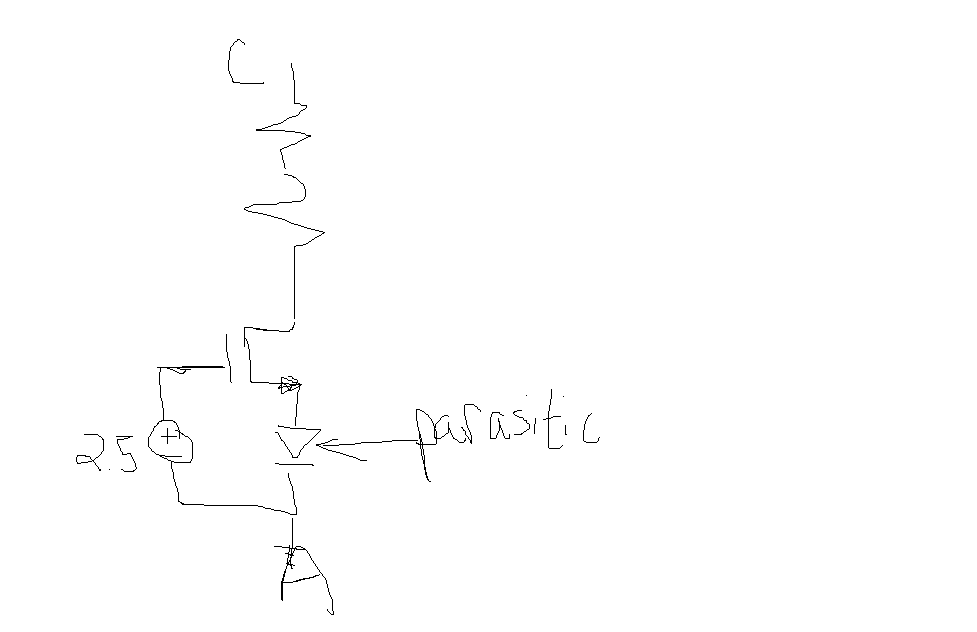

  • Thanks Lucas. This makes more sense now.  This behavior is not consistent with how I would interpret the spec. Let me get some data on the EVM and ask design.
    -Artem
  • Lucas,
    I collected the following data on the EVM, which seems to be in line with what you were saying. Negative I_in means that A is sourcing current.
    Vin (A) Vout -  C I_in
    0 12      -1.3mA
    6 12      -0.97mA
    10 12      -81.9uA
    11 12     190uA
    12 12     345uA
    15 12    986uA
    Also we identified the leakage path in silicon.  Still working on estimating the tolerance would be. Voltage on the Vgs of the Vg of the FET is 2.5V.
