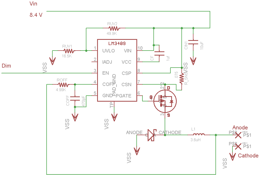

LM3409 driver design problem
Other Parts Discussed in Thread: LM3409
I am having trouble with a LM3409 driver design. I made a PCB but the buck regulator is not working. It's just passing the input voltage to the output. In other words I think pgate is always keeping the p-fet on despite if the enable pin on or off. I have 3 copies of the assembled board, all with the same behavior. I believe it is the design and not a short or something in the hardware.
This isn't exactly my area of expertise so I might be missing something obvious.
Any ideas on how to troubleshoot this would be very helpful.
Thank you
Desired specs
Vo 3.5V
Vin 8.4V
Current  3A
Part Value PN Manufacturer
L1 3.6uH SRN8040-3R6Y Bourns
D1   CD214A-B320 Bourns
Pfet   FDT434P Fairchild
R_uv2 49.9K
R_uv1 16.5K
R_off 4.99K
C_off 470pF
R_sence .075 ohm
CF 1uF
C_in 10uf
