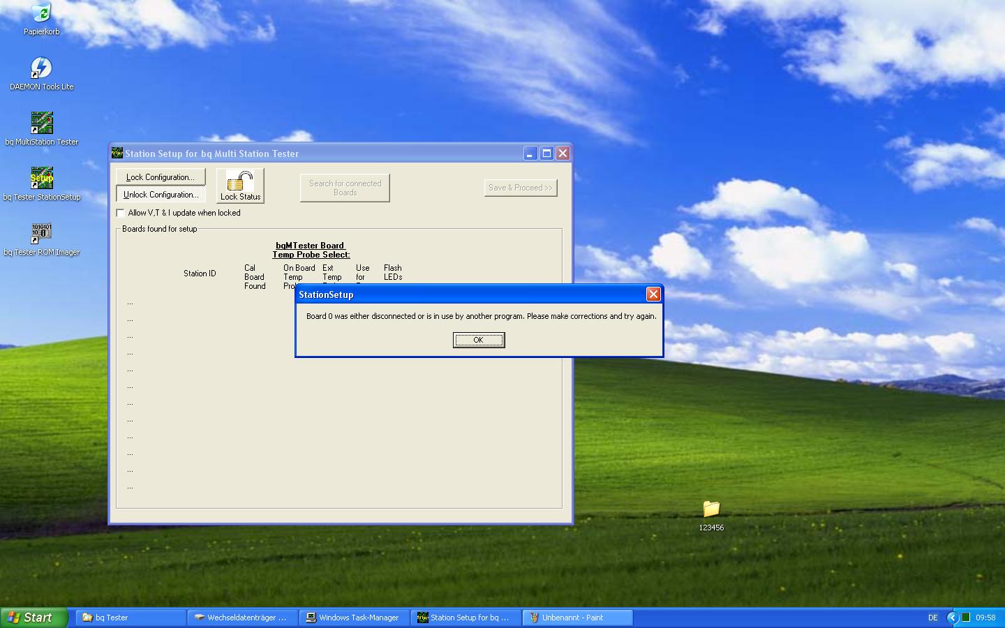

Dear all,
we use the BQ20z65R1 v1.05. We want to use the advanced BQMtester HPA495 Softwareversion TIbqMultiStationNB2.18Setup.exe, to flash and calibrate the BQ. The problem is, that we don’t have the right BQ version in the BQMtester-software, so we added it to the Targets-File, as follows.
"bq20z65R1 v1.05","650.1.05"
We think it is right, but when we set the option for writing the DFi, the Multistationtester.exe didn’t open. The error is as follows:
"Single site InitCacheFromSetup() failed for board Test0l.Error code =65557"
First we thought it is a mismatch with our DFi-Header, but then we tried to use a BQ which is in the Software as standard and use a DFI from the BQ-Eavaluationsoftware. This ends up with the same error. So it couldn’t be a problem with our DFI-File.
Software was uninstalled and reinstalled for being sure that not a corrupt file is the reason. Also we use the EV2300 with the lable “USB Tester Ready”.
Another question is, how you connect a 3s BQ-Board, and which DMM-Port do you use for calibration. Do you leave the 4p port not connected and measure the DMM2-port for calibration?
Thanks for your assistance and I’m looking forward to hear from you.
