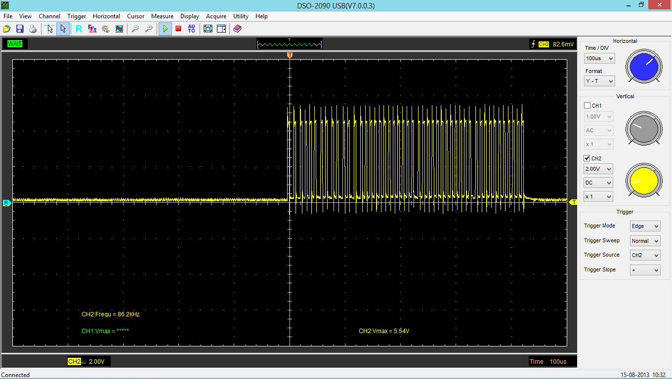

Hi everyone. I tell you i'm working with a "TLC5973 LED Driver Single-Wire". But aparently the signal that i'm sending is not recognized, but i don't know why, because it's the same as figure in the datasheet. Here i send a pic of the signal generated.
Sorry my english!
Thx
PD: The information sent in this image is 0x3AA, 0xFFF, 0xFFF, 0xFFF.

     It seems that your 2'nd rising edge for logic '1' data input is input after 50% of tCYCLE.
     When you want to input logic data '1', you need to input SDI 2'nd rising edge must be input before 50% of tCYCLE.
     Please try to input SDI with the timing above.
