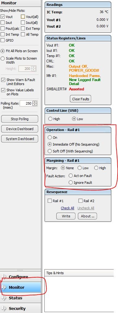

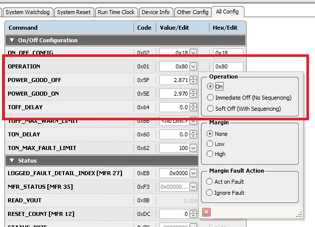

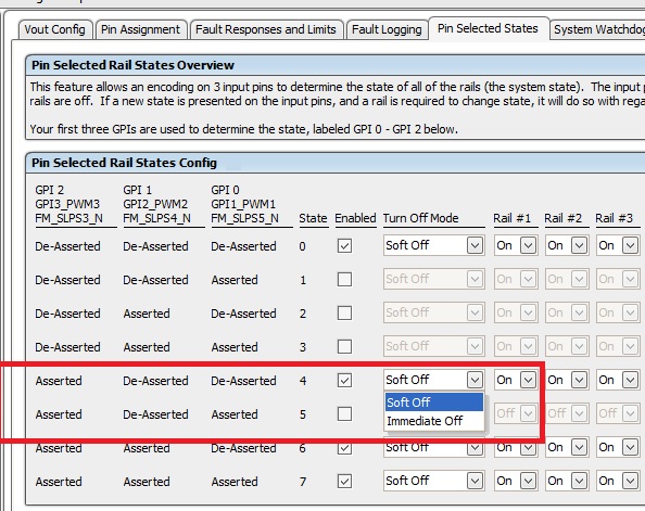

What is the difference between "Pin Selected State -> Turn Off Mode" and "All Config -> On/Off Configuration -> Operation" ??
Hi Kevin,
The "Pin Selected States" tab allows your first three GPIs to determine eight different system states.
The Operation section under All Config has to do with the Operation section under Monitor. It is just another way to send the Operation command when the rail is set to Operation only:
