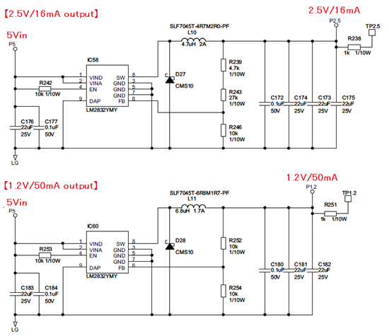

Although examined by attached specification, low output current should also teach how to make it operate by continuous conduction mode.
(Is it a method except enlarging an inductor?)
Moreover, how much does ripple voltage become?
Thank you for your consideration.

  • LM2832 is a non-synchronous converter.  It will operate in CCM only if the load current is greater than 1/2 the peak to peak inductor ripple current.  For example in case 1, you would need to limit ripple current to 16mA/2 = 8 mA.  That would require an inductor value of 284 uH.  LM2832 is internally compensated.  It is usually designed for higher output currents.  You may have stability issues using an inductor 60 times larger than 4.7 uH.  Why do you need to operate in CCM?
  • Is there any special reason why CCM operation at 16mA is preferred?
    If CCM operation is a must, a synchronous buck converter with FPWM mode at light load should be a better option.
