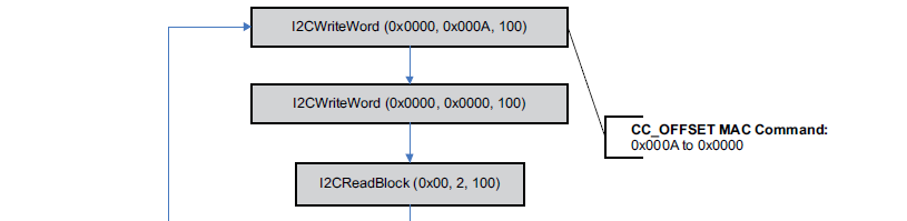

Besides that, I have some doubts after reading the document. Picture below is taken from the flow chart for CC offset calibration. In I2C write word operation, what does 100 referring to? As for the read block operation, what does 2 and 100 referring to? Both 0x0000 and 0x00 refer to manufacturer access?

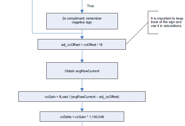

Here is another picture which shows the formula for current calibration calculation.Formulas such as adj_ccOffset = ccOffset / 16 and ccDelta = ccGain * 1,193,046 are meant for the bq chips mentioned above only? If it is what is the correct formula for bq34z100 ?
Also i found the steps mentioned in voltage calibration seems not compatible with bq34z100 because bq34z100 is changing the voltage divider value after calibration instead of vOffset. What are the correct steps/formulas required?

  • Shirley,
    We do not have a document published with calibration code examples for the bq34z100, but the process flow should be that same as that shown in the SLUA640 document. The read and write command structure is different for the bq34z100. You can find the structure for this device in the SLUA665 document.
    Basically, the device has Control subcommands to aid with calibration. see page 10 of the device datasheet.
    Voltage calibration will be different for the bq34z100, because it can support more than one series cell.
    If you need more detailed information, then I will have to get help from the some other engineers who have more experience with programming.
