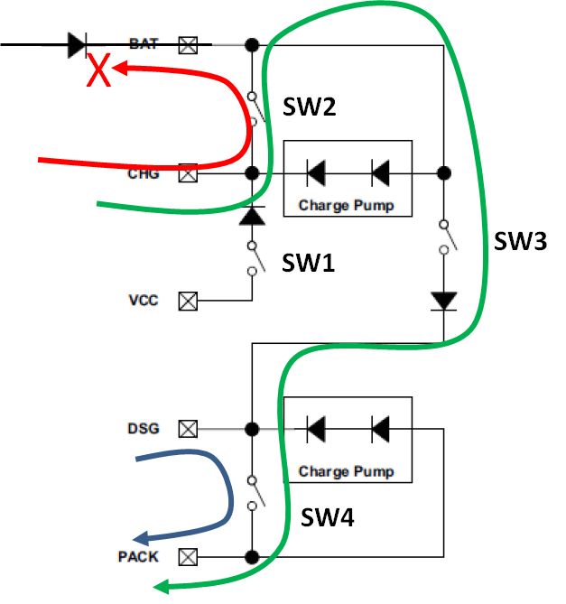

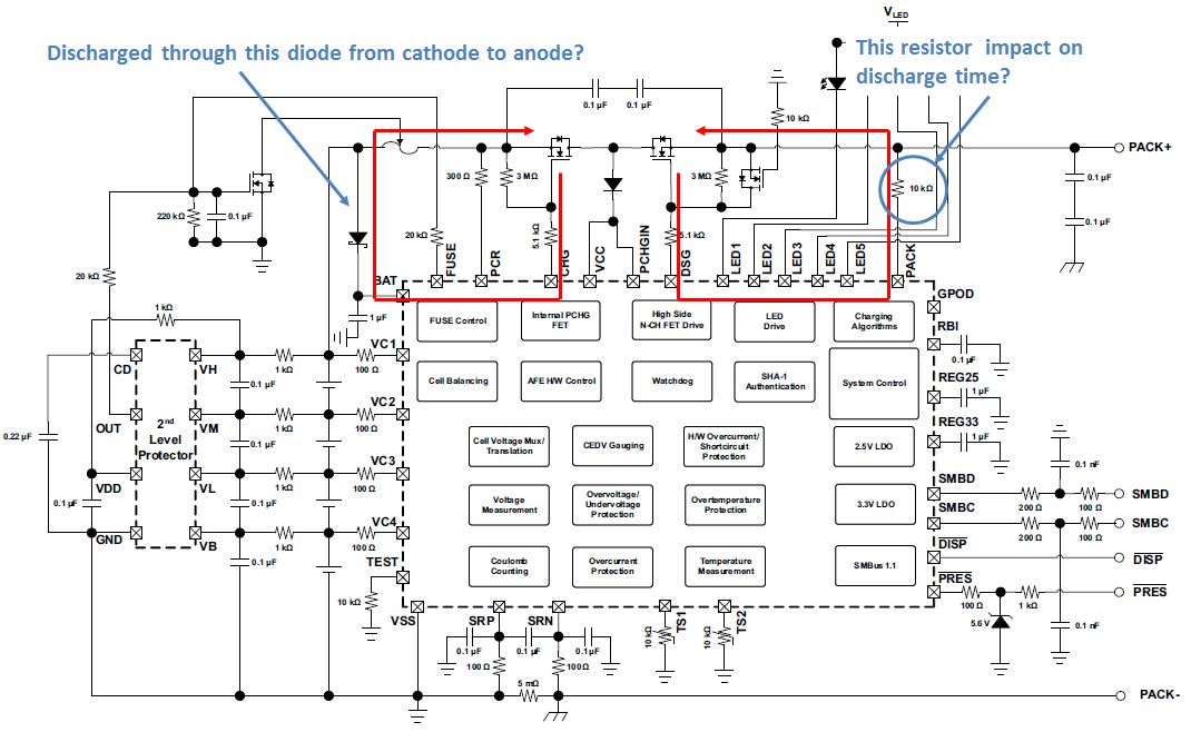

Our customer is now evaluating bq3050 and they would like to know about components which affect for fall time of Nch FET drive. Of course they understand that the CL and Rg willl be affected for it so they would like to know the other components for affecting  for fall time, Tr.
I believe that there is no external components if the Nch FET will be turned off by sank with constant sink source like attached. I can not see detail of internal block, so can you please give your comments?
