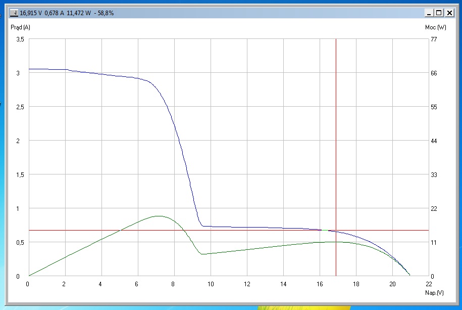

Solar Magic controllers and partially shadowed PV modules
I tested Solar magic module and found that when we have partially shadowed photovoltaic module, controller select the MPP with bigger voltage (right) but better is point with bigger power (left). I should be obliged if other Solar Magic users send me opinions concerning this effect.
