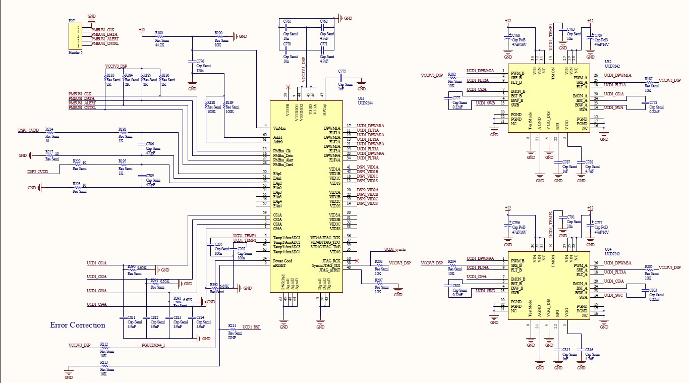

  • Hi,Naveen HN,
      I was working on UCD9244+UCD7242 to powe supply for TMS320C6678, when i congiure my project ,I just saw o output and the duty cycle was always 0.Did you konw why? and I was just not sure if i must change the CVi, RVi1, RVi2, Cp, Rd1and L  in the "Edit Full Power Stage in Schematic "  so that these values match with my own Circu? wish you help ,thanks a lot.
  • Hi LBJ,
    There could be many reasons for NO output. Make sure that the schematics, assembled components are correct. Check whether the TI GPIO adapter is able to detect your UCD9244 device on board and able to program your UCD device with generated XML file. You can change the values of CVi, RVi1, RVi2, Cp, Rd1 and L according to your circuit. You can see the output power supply behavior in simulation for the values that you have changed. Looking into your problem, I think something is not enabled because of which you are not getting any output. You can share your xml and schematic screen so that they can be checked. Hope this helps.
    Naveen
  • Thank you very much ,Naveen!
        My USB adapter can detect the 9244 and my XML file can program into the device. And when i also change the CVi,RVi,Cp,etc. the output was still 0,the duty cycle was 0, so there must be something wrong whith my schematics or my XML file, attachment are my schematics  and XML file. I use one 9244 and two 7242 to provide 4rails with 1.1V core voltage, but now we just use rail1 and rail2, the rail3 and rail4 are not use by now. I appreciate your help,thanks again, in great need of your help. 4370.UCD9244_930_two_core_rails.xml
  • Hi LBJ,
    I am not an expert on these power controllers. I am providing these observations based on my previous work with UCD9248. Anyone from TI can correct the observation if not correct.
    1. The nRESET of UCD9244 is pulled down to GND. It is recommended in datasheet to pull-high with 10K resistor.
    2. Capacitor connected to BPCap must be 0.1uF where as it is 1uF, not sure whether this matters?
    3. VinMON resistor connected to +12V must be 56.9K or 57.6K.
    4. Are you using VID pins for controlling the output voltage? What are the values used for VID on board? As per the xml file, the VID is set to 6-bit mode. You can set it to 4-bit mode and set all VID1 inputs to HIGH so that you will set output to 1.103V. Also, you can check with "Ignore VID" option in VID tab and provide VOUT command through PMBus and check for output.
    5. If you are using all rails of UCD9244, rail 1 output must be connected to EAP1/EAN1, rail 2 to EAP2/EAN2, rail 3 to EAP3/EAN3 and rail 4 to EAP4/EAN4. Make sure all connections are proper including VID for all 4 rails.
    Please check the above and let us know your observations.
    Naveen
  • thanks,Naveen
      From my point,
      1.The EVM nRESET of UCD9244 also pulled down to GND,and the UCD9244 document's  Typical Application Schematic suggestion also show pulled down to GND.
     2. BPCap  can be 0.1uF~1uF(UCD9244 document page 18)
     3. I can't find VinMON must be 56.9K or 57.6K ,can you give me a link?
    4. I did't use VID by now
    5. I did feedback the rail to EAP1/EAN1,etc.
    I dout if i miss someting or my XML file was wrong, could you tell me which part of the "fusion designer " should i Pay attention to?? many thanks to you
  • Hi LBJ,
    1. On nRESET signal, refer to UCD9244 datasheet, page 11 where it is shown that 10K pull-up is required. JTAG_nTRST is to be connected to GND through pull-down resistor. Remove the pull-down resistor connected, replace it with capacitor and use a pull-up resistor (10K). Think this should help to bring the device out of reset and see the output. You can follow the reference schematics in datasheet.
    3. VinMOD resistor is mentioned in reference schematics in Page 11 of datasheet and also it is one of the value generated in TI Fusion Designer tool.
    4. As per your xml setting, you have set it to 6-bit VID mode and not using VID, think these are floating in your case. If you see "Configure" tab section in TI Fusion designer, under "VoutConfig", on the right side there is a comment saying VOUT will be set by VID code. This means that if you don't use VID, you may not see the output. Could you please connect these to proper levels and check the outputs?
    Wanted to check how are you controlling the VID inputs to UCD9244 device? Better option is to set the VID to 4-bit mode (in "VID Config" tab) and pull-high all VID pins to VDD (3.3V) using 10K or 22K resistors for each VID line.
    Please check and let us know what happens.
    Naveen
  • thank you,Naveen
         the problem has solved ,thank you very much!
  • Hi LBJ,
    Good to hear that your problem is resolved. For our knowledge, could you please let us know what was the issue and how was it resolved. This would help others.
    Naveen
  •  wo just make sure the Capacitance next to the output rail are wrok well, because wo found that Capacitance was brokn down before,and the output feedback to EAP/EAN was wrong. wo just had the two problems, thanks.
