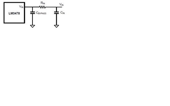

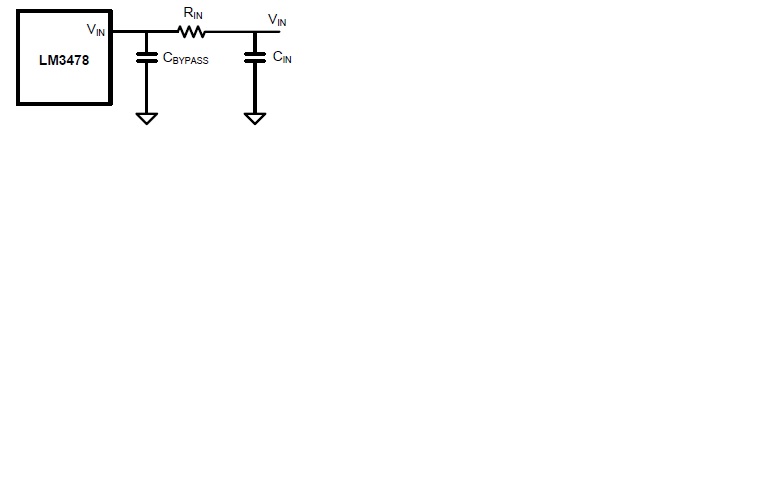

    2) You could also introduce a delay circuit which basically delays the switching. A resistor introduced from Vin pin to the input power supply along with a bypass cap already connected from Vin pin to ground would help generate a delay. The resistor value could be calculated as follows:
    R = tDelay/(C*ln(Vin/(Vin - Vinmin)))
    Where,
    tDelay = required delay time
    C = input bypass cap
    Vinmin = 3V for LM3478/88
    Vin = minimum vin of the required design
    Another solution is to use the LM3481. The LM3481 does not allow a 100% duty cycle and has an extra pin with which you could configure the UVLO. I hope this information is helpful.
    Akshay
  • Hi Akshay,
    I really appreciate your help.  Just to clarify, on suggestions #2.  You just mean a simple RC circuit like this, right?
  • That's right, Jamaal.
