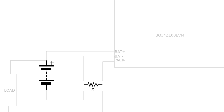

I'm trying to use the BQ34Z100EVM to monitor a 48V Lead acid battery. The battery is 4x12V Lead Acid batteries connected in series.
The load will  be drawing a current of 5A-25A with a peak of around 35A.
I am aware that the datasheet states that the board doesn't support currents of more than 7A. I would like to increase this limit. On checking the schematic, The current goes through the board only through the current sense resistor.
Is it possible to get a different current sense resistor with a higher power rating and bypass the board. Theoretically that should work right?
