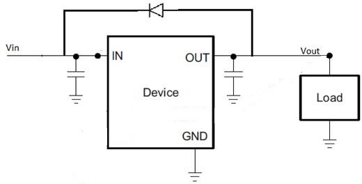

I think that TLV1117LV series doesn't have the Reverse Current Protection function.
If there is possibility Vout>Vin,  should we add the reverse current protection diode between Vin and Vout?

    You are correct that we do not have the reverse current protection functionality on this family of parts; however, due to the PMOS pass element we are afforded some protection due to the body diode.  We describe it on pg 10 of the datasheet:
    The PMOS pass element in the TLV1117LV device has a built-in body diode that conducts current when the
    voltage at OUT exceeds the voltage at IN. This current is not limited; if extended reverse voltage operation is
    anticipated, external limiting to 5% of the rated output current is recommended.

    Could you please kindly let me know the example of external limiting circuit ?
    For example,   Diode between Vout(Anode)  and Vin(Cathode) ?
             Or , Diode between Vout(Anode)  and the Load(Cathode) ?

    A diode between Vout and Vin is what is recommended.
