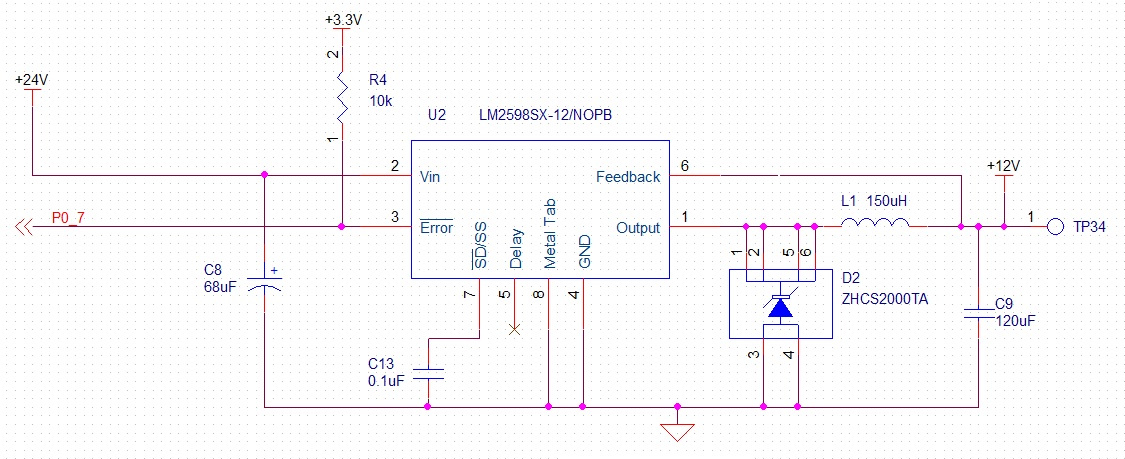

LM2598SX-12/NOPB Not Regulating to 12V
Hello, I am trying to regulate from 24V to 12V using the LM2598SX-12/NOPB. I followed the design process in the datasheet, but I am getting an output that wanders from 1.8V to 3.2V. My estimated max current output is 750mA @ 12V. Below is a diagram of my circuit.
BOM:
C8 = Panasonic EEH-ZA1H680P
C13 = Kemet C0805C104K3RACTU
C9 = Vishay / Sprague 595D127X0020R2T
D2 = Diodes Inc ZHCS2000TA
L1 = Bourns SRN1060-151M
Any help getting the output to 12V is appreciated. Thank you,
Rob
