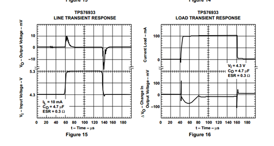

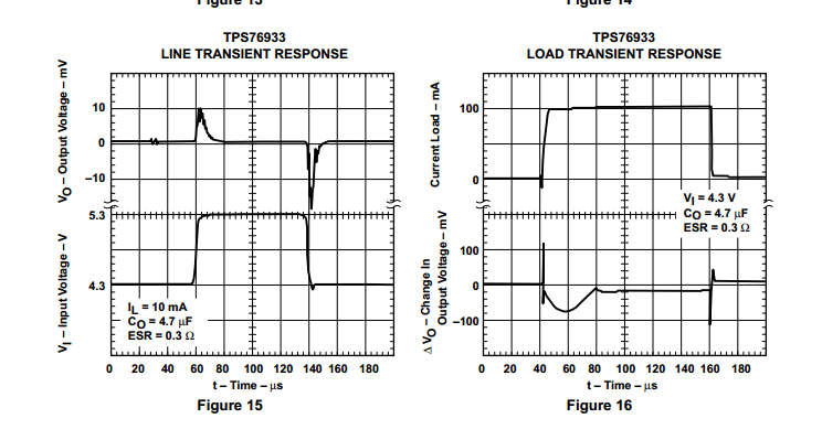

TPS76933 Response for sudden load change
In my application TPS76933 has been used to provide power to RF IC. During transmission my RFIC is going to draw a step current of 30mA for 1.5 ms, rest of the time current drawn will be 1 to 2 ma.  The TPS76933 is used with a bypass capacitor of 4.7 uF. I need to observe the transient response for the sudden load change to make a robust design. In this regard if u can provide me a spice macro which is compatible with tina ti will be very help full for me.
