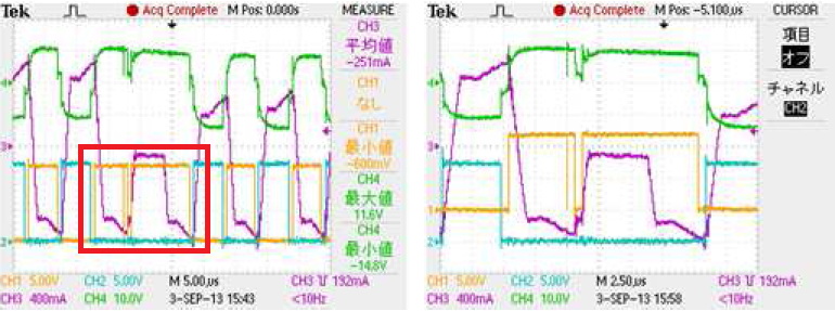

I’d like to ask about the function of UCC28950.
My customer evaluates load transient on his DCDC converter board, but he found some abnormal function.
He confirmed that outC/D lock up for 1 cycle after load transient(500mA→50A) regardless of outA /B waveform is normal, and he said this causes bias magnetism of transformer.
-CH1:outC
-CH2:outD
-CH3:current flowing through the primary winding of power transformer
-CH4:pulse transformer(primary side)
Is it probable function that outC/D lock up regardless of outA/B waveform is normal?
I think outC/D is associated with outA/B, and outC/D doesn’t lock up independently.
Could you advise me please?
I’m sorry that I can’t get schematic of the board(it is my customer’s matter).
The condition of DCDC converter board is Vin=270-280V, Vout=28V/50A.

    In the our customer, OUTA and OUTB are normal operation.
    But OUTC and OUTB are pulse skipped. (Please see the Yaita's first post as waveform)
    <Conditions>
    Vin=270-280V, (they tested Vin=260 to 400V, but pulse skip occur at 270 to 280V)
    Vout=28V
    Iout=50A(1.5A/us , ΔI =49.5A)
    RTmin=13k ohm ( same with minimum allowed restor on TMIN)
    OUTE, OUTF pins are open.  They don't use Synchronous Rectification.
    DCM pins connect to Vref.
    Are there any possibility of the OUTC, OUTD pulse skip at the above conditions ?

  • When the duty cycle is less than the programmed on Rtmin the device goes into burst mode and gate driver pulses can be missed.  I believe this is what is happing.
    Mike
  • An example of burst mode is shown in figure 23 of the User's guide showing the missing pulse.  http://www.ti.com/litv/pdf/sluu421a

  • What made believe this was burst mode is that test conditions were 500mA to 50A.  At light load the converter could be going into burst mode.  You just need to look at the duty cycle to see if this is the case.
    Not sure why it is not occurring at 270 and 290, and only occurs at 280.
  • Hello Mike san,
    At the customer, this occurs only about Vin-280V... (attached for your reference)
    This operation is not occured by 500mA.
    Occured by dynamic transient response and specific Vin.
    Our customer commented duty cycle may be 100%...
    Is burst mode caused of 100% duty cycle?
    If yes, we can avoid this operation by changing turns ratio of transformer ?
    I will check the OUTA, B, C, D waveform to our customer for more information.
    But pleaase let me know.
    Ryuji Asaka
  •  Hello Ryuji,
    The map that you have attached shows that condition most of the behaivor happens at load steps of 0.5 to 50A.  At 0.5 the converter maybe calling for burst mode.  You could also be hitting peak current limit.
  • Hello Mike san,
    I think that OUTA , OUTB, OUTC, OUT D will be off under the burstmode.
    In the datasheet figure 2 , OUT A, B, C, D are off.
    But in customer operation , OUTC is High and OUTD is Low.
    I think that this is not burst mode.
    In the burst mode,  OUTC will be High and OUTD will be low ?
    If yes, I will inform this operation caused by Burst mode.
    If no, please let me know the assumed cause of this operation?
    If we can't identyfy by current information, please let me know should we check...
    Please see the attached file as waveform.
    Ryuji Asaka
  • There are only two functions that will cause abnormal gate drive.
    1. Burst mode, Duty Cycle is less than Rtmin
    2. Peak current limit
    If it is not either of these you might have layout issue.

  • Hello Mike san,
    This gate operation is not occured when our customer use low value Rcs.
    Please see the below picture as pulse skip wave form.
    This waveform is result of Cycle-by-Cycle Current Limit Current Protection and Hiccup Mode of the UCC28950.
    Thus, this behavior is along the datasheet.
    Is my understanding correct ?
    Ryuji Asaka

  • It looks like the load step transient is causing the UCC28950 to misfire and cause the output C to turn on when it should be off. Please look at the drive outputs A,B,C,D. Check the layout of the gate drives and see that the ground to the UCC28950 is not directly connected to the power ground of the system.
