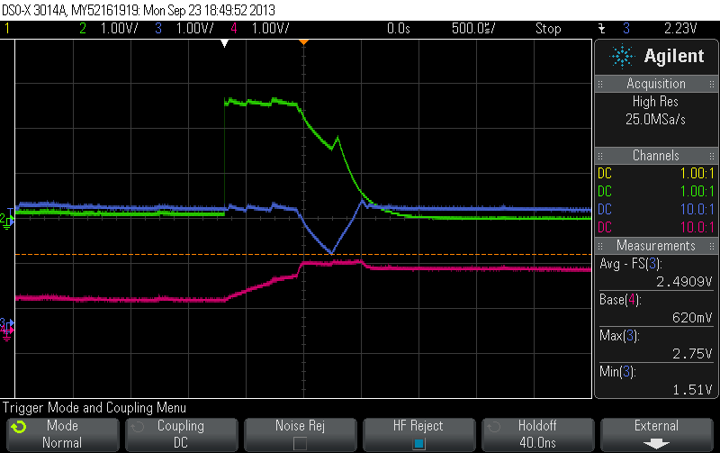

    I've attached a screenshot:
    In the image, the PINK is the 2.8V output line and the BLUE trace is the 2.4V buck-boost that feeds the TPS61260. The GREEN trace is a GPIO from the MSP that I set to toggle when the NAND write is enabled (regulator is turned on). As you can see, the 2.4V dips to around 1.5V but is still above UVLO per its datasheet.

  • To follow up from that previous post with a screenshot, what you see there is the 2.8V regulator failing to initially startup. The ramp on the PINK trace is the SPI back-charge I was referring to in the post (it pre-charges the node to 2.4V) where the boost regulator then kickstarts itself up to 2.8V.
    Unfortunately, this startup pulls a lot of current causing the 2.4V to drop to 1.5V which resets the processor.

    It does appear the you have 1.8V while having 2.4V in on the right of the waveform.  Normally, this would mean that the TPS61260 is in current limit and can't raise the output higher.  Could you check the output or inductor current for this possibility?
    The board to board variation might come from different batteries or even the same battery at a different state of charge.  1.5V is right at the UVLO level of the TPS63030, so I wouldn't be surprised if this waveform looked different on different boards of yours in case the Vin reached UVLO of some devices.
